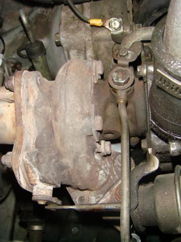

88 EA82T Posted June 23, 2010 Share Posted June 23, 2010 I need some assistance/advice from those of you more experienced in turbos than I am... 1988 GL10 Wagon AWD MT 1.8L Turbo (obviously) It looks like I am leaking coolant inside the turbo and it is coming out on the flange that connects to the exhaust pipe. You can see the white dried up stuff on the flange and where the waste gate actuator connects. I cannot see any white dried up stuff on either of the exhaust headers where they connect to the heads so hopefully it is not leaking at the headgaskets or from the heads. So I am guessing that the coolant is leaking in the turbo and getting blown into the exhaust then burning off. My coolant reservoir looses maybe a 1/4" of inch every couple of days and I do not have any other coolant leaks on the car. The oil on the dipstick looks like oil too. So does it sound like it is just the turbo leaking coolant? Anything else I should check out? Link to comment Share on other sites More sharing options...

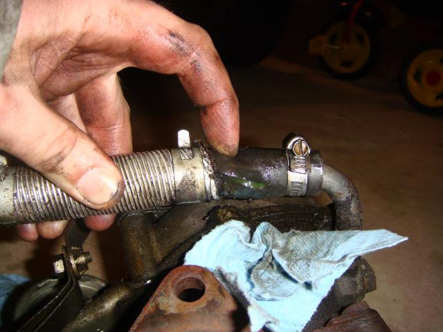

88 EA82T Posted June 24, 2010 Author Share Posted June 24, 2010 Well, I just replaced the coolant line in the picture on the bottom of the turbo which wasn't fun since I had to remove the turbo to get to it. I am sure all of the coolant lines are tight and not leaking so I am thinking it is something internal to the exhaust and/or the turbo. My antifreeze looks green but I did just put a gallon in to top it off after the coolant line on the turbo split and I replaced it. I think my overflow bottle has gone down about 1/4" from full in the last 100 miles or so. If I do have a leak it is a pretty small one right now. I did see some brown sticky stuff on the radiator cap when I topped off the radiator. I am not smelling burning antifreeze in the car or out of the car. Maybe it smokes a bit as car warms up? I was just chalking that up to cold mornings but maybe there is more to it? What would the antifreeze look like if it had oil in it? Link to comment Share on other sites More sharing options...
