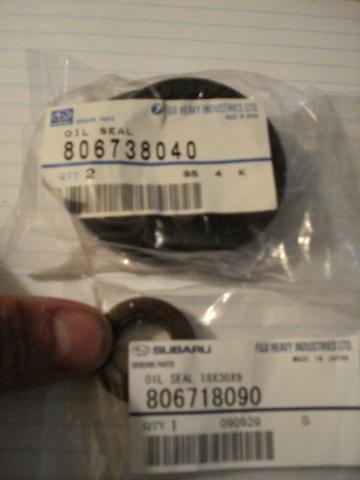

Does that small seal in the pic look like the crank seal??? That's what I ordered and thats what 1st subaru sent. Looks small but I have not taken it apart yet

by shaft seal you mean the crank seal?
Any coments about the size of the crank seal they sent me/? its the size of my thumb...could that be correct?
no. it says "oil pump shaft seal" ?

any coments about the size of the crank seal they sent me/? its the size of my thumb...could that be correct?
size of your thumb does not sound like a crank shaft seal, sounds more like the oil pump shaft seal. on the EA82/ER27's the oil pump and crank seal are completely separate - oil pump is driven by the timing belt, not directly by the crank like on EJ stuff. maybe that's why you're confused?

The smaller seal you have in the picture looks like the oil pump shaft seal.
