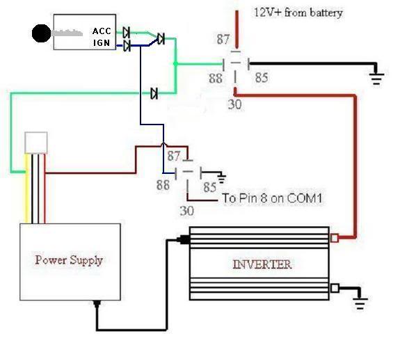

July 2, 201015 yr I posted in your other thread this info, but thought I would post it, since this is where you are actually going to use this info This is just a copy paste from the other thread... I make such circuits every now and again for electrical projects I work on. I just make my own. A 555 timer and the right supporting circuitry can get the job done. Just run it off a constant 12v. But if I was only using it to "push" the power button for a few seconds I'd just get a small cap and transistor. It would only take a very small cap to have a transistor connect a circuit for a few seconds. You aren't powering anything, just connecting something, so it's pretty easy. I had a computer system in my car for a little while, and this is how I had it set up. I had constant 12v going to the system always. I made my own 12v power supply for it (pretty easy if you can build electronics). I had it hibernate when the car was shut off, and this is how I made it all tick. When the car turned on I had it give the computer "power button" and the computer PSU (more on that later) a pulse to wake up the computer. It would then come out of hibernate. I used a 555 timer for that. Putting the computer back into hibernate was the more difficult part. I used the serial port and a custom input board to tell the computer to go into hibernate. Basically when the key was off it would open a relay and tell the computer to go into hibernate asap. Then it would just turn itself off. Now, when I said more on that later. I also had a relay to give the computer constant 12v, powered by the LED that indicates power to the computer. So when it got the ON pulse the LED would come on and close the relay. Then the ON pulse would go off, but the system would have power. When it shut off the LED would go off removing power to the system to prevent it sucking the battery dry. I took the system out because someone gave me some broken iPods. Pretty much all I used the system for was music and I got one of the mp3 players working. So due to simplicity I ripped the system out. This is good! I like this. Here's a schematic for the above and a explantion: Source carPC Turn On / Shutdown Controller Material needed 2x SPDT standard automotive relays - automotive store or electronic store 2x Diode - Radio shack or electronic store 1x Serial port connector - Old serial device (mouse, joystick etc...) or radioshack or electronic store 1x Fuse holder + fuse <- VERY IMPORTANT !!!!! (if power source already fused then you're ok) 10g or 12g wire for providing power to the inverter (bigger is better) 16g to 18g wire for your relay triggers, grounds and 5V connection Misc. connectors In the BIOS set your motherboard to turn on after powerloss so the second you feed power to the power supply it will turn on. Get an old serial port device, rip the connector off of it, take the cover off and solder a wire on PIN 8. If you look very closly the pins will be numbered on the connector. When PIN 8 is not getting 5v, it will initiate the windows shutdown. (credit to Laidback) Refer to the diagram for wiring. Go into your control panel -> Power Options - Create a generic UPS with these settings (picture bellow this one) note: some versions of windows xp does not have the UPS tab (ie: windows xp home) - xGROMx More details and hints: -The numbers you see on the diagram (87,88,85,30) are the pinout of a standard 12v SPDT relay -The >| symbol are diodes, they are crucial to making this work. -You can use your amp's turn on wire to make this work instead of ACC, however some amps may "thump" when the carPC turns on. The real ACC can be found in the head unit harness. -Some cars turn off the ACC while being started, this may trigger the hibernation. The diagram below will solve this problem Updated diagram - will only work on ignitions that have a key switch (most cars do). To know if your car has a key switch, leave your door open and put the key in the ignition w/o turning, if you hear a door chime, you have a key switch. It can be found right on the ignition plug itself. This may be a little more advanced for some users, testing with a multimeter is the only way to find the right wire. This will only trigger hibernation when the key is removed from the ignition -------------------------------------------------------------------------- Updates - July 2006 Alternative to the key switch method, to avoid hibernation being triggered when starting and the ACC turns off during cranking. -Important to follow the diode connections as shown below Enjoy So ya I would combine the methods together like so: Wire in a relays with the caps like here: Bummer.. I did find this though on MP3car.com how it supposed work : 12V apllyed to to coil of the first relay (between 86 and 85) This activates connection between 87 and 30 so current can flow to the coil of the second relay with will load the capacitor. Moment capacitor if full, potential level between 86 and 85 will become 0 volts and coil 2th relay falls off. Puls generated. By take off the 12 volts : Coil 2th relay (pin 86) connects to ground. Capacitor discharges via coil Coil active (87 connected to 30) Capacitor discharged Coil falls off. Puls generated. This will create the "on pulse". Then wire up your power inverter relay off the LED like 987687 did, this will keep the power inverter on until the computer shuts off. Then wire in a relay to the ACC on the ignition for the shutdown circuit, so that when you turn off the car, it sends a signal to the carputer to hibernate, and when it does that and the LED turns off, the power inverter turns off. I think that is what you are looking for Turns the carputer on, and then cleanly shuts it down without draining you battery, or your wallet... You might get a second pulse from what I have read, but just set the carputer/windows so that it does nothing when the power button is pushed. You are using the UPS funtion to control the power now, so no need for the power button to do anything, once the carputer is on. At least I think you can do this... (I just verified that this is true...) Edited July 2, 201015 yr by eulogious Added info on 2nd pulse

July 2, 201015 yr Holy Cow Eulogious! That's a lot of info! I was kind of thinking along your idea for having it all computer run, such as just plugging in a set of pc speakers or a pc surround sound setup. There are so many options for a pc setup that's its not even funny. And the info linked to by eulogious is exactly what you need for the automatic on/off setup you've been looking for. Twitch
