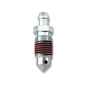

you might consider new hoses if yours seem worn, they can 'balloon' and make the system feel soft, also, consider going back with SpeedBleeders;
they have a check-valve inside. not cheap though.
Speed bleeders don't do any good. Just a waste of money. If you had the blesses loose at one point an easy out may be able to remove them. Otherwise you may just have to drill them out.
