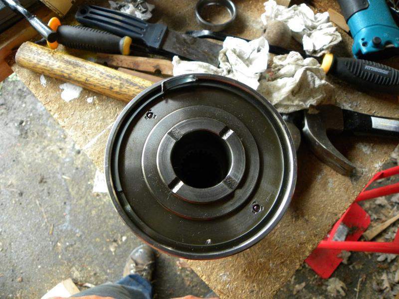

I took a look at the center differential from my original transmission... this chunk of metal out of the first junkyard transmission sure looks a lot like that retaining clip. Thoughts?
