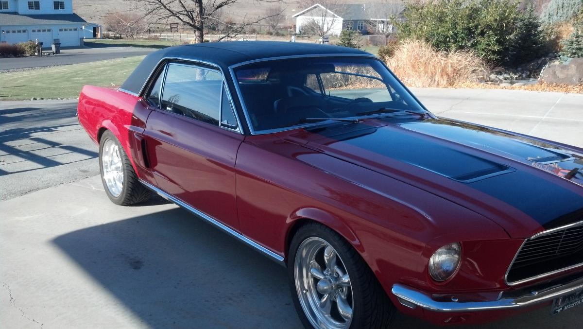

Its called OCD! I went from building this 1968 stang
post-52352-0-14440600-1396421917_thumb.jpgpost-52352-0-13773200-1396421938_thumb.jpgpost-52352-0-85563400-1396421956_thumb.jpgpost-52352-0-05543800-1396421978_thumb.jpg

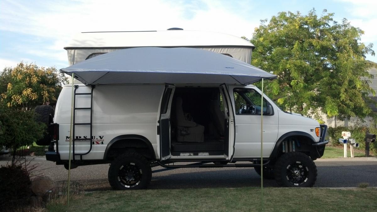

Then when I finished I began building my custom 4x4 E350 7.3 psd camper van
post-52352-0-04115900-1396422075_thumb.jpgpost-52352-0-78248800-1396422095_thumb.jpgpost-52352-0-48511600-1396422115_thumb.jpgpost-52352-0-92496900-1396422142_thumb.jpg

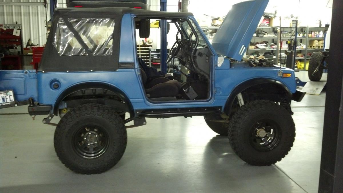

Sold the Sami to began my brat build....don't sell the brat just move onto something else!!
Buck
Samurai was the first thing I ever went offroading in. That was back when you could still pick them up for $600 instead of the $6000 they go for now.
