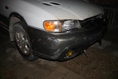

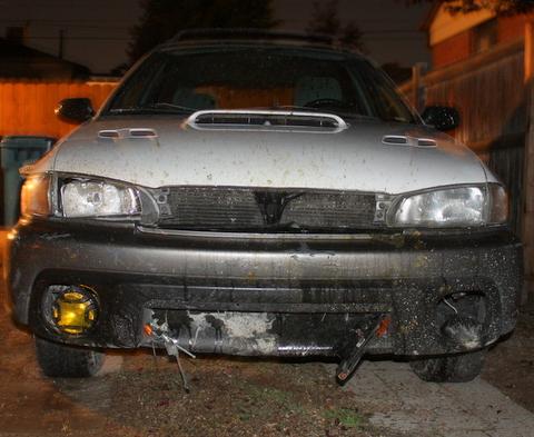

December 8, 201312 yr Author Pre fog light installation... Edited December 8, 201312 yr by impoutback 97
