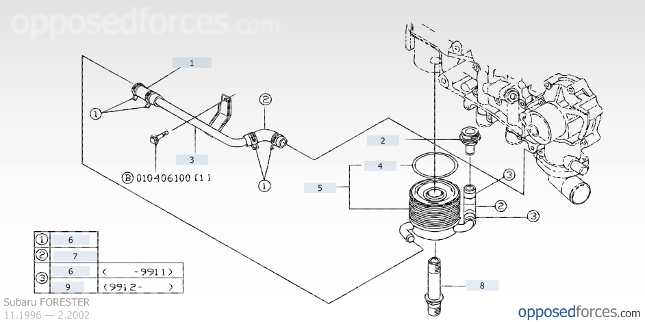

the correct name is oil cooler pipe, The bypass pipe goes from water pump  and tees into the IACV and heater input.
see
