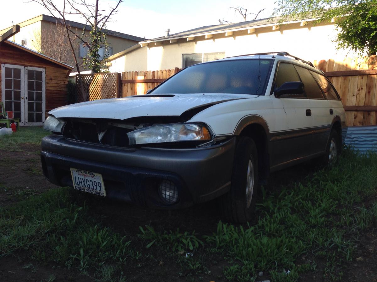

Here's a pic of her. I haven't really found anyone else mention this potential fragility of these cars- that a sideways impact to the front corner can cause body/frame rails to smash cam gears and kill the motor. Otherwise, it could've driven away. No airbags went off, no coolant rupture. No tires rubbing, though alignment was wayyyy off. But yeah, for a car that seems so tuffy, a mild slideways hit and it's done. At least I managed to not get a ticket, and most importantly no one else.

This motor survived! I yanked the "frame" out enough with my truck to get away from motor, put cam gears and belt back on and it fired up! This interference ej25 totally survived having timing gears smashed. And then cranked right after. Only thing I can figure is, since I think it had dropped to idle before I found the guardrail that the hit pretty much stopped the motor where it was when belt got pinched, and valves where all enough closed that when I cranked on it nothing hit. I heard from a Subie mechanic that these are technically interference motor, but not by that much. It was exciting.
