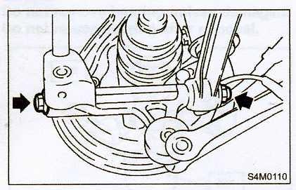

I am having a heck of a time with the Lateral Link Bolt. (drawing attached)
It seems to be rusted to the bushing collar and will not budge.
With a breaker bar and a cheater, it will rotate, hard then the bushings
"give-way" and it pops. Basicly the bolt, collar and bushings are all rotating
in the rear housing. Any ideas?
At this point, short of burning out the bushings and cutting the bolt at both ends,
I am stuck. Even if  burn the bushings out, I do not think the collars will slide
through the rear housing? I have never had this apart before.
Thanks, Bill

Must not be a colorado car.  Yes you have to cut the bolt.  Easier to go to the UPull and Pay and get good rust free ones.  You could also convert to disk brakes if you wanted to.

I take it you have soaked the link bolt and bushings for a few days before trying this?
Most of the time I don't have problems with CO cars getting this bolt out.  Soak it and then try it again.

Liquid Wrench  a couple times a day, I have not given up getting it out.

yes, let is soak forever, for days, keep it always soaking at every possible entry point.  soak and wrap with wet rags if you can of the liquid wrench.
I wonder if you could drill a small hole all the way through the bushing so that you could slide a nail or punch all the way through it (missing the bolt of course) and lock it in place?  then you can turn the bolt without any of that stuff rotating.
i guess you see the bushing turning, that's why you know it's turning as well and the bolt isn't simply stripped?  if it's turning shouldn't it be unthreading still?
remove all the linkages from the bottom of the vehicle will get the entire assembly off the vehicle so you can work on it on a bench.
you could also drill it out.
Good idea to hold the bushing, No it should just slide out once the nut is off.

I do tons of wheel bearings on Subarus. The ones I have with rust and a non moving lateral link through bolt, I just remove the knuckle with both lateral links still attached from the subframe. It seems like it might be a PITA but better then cutting and grinding and the frustration you have to deal with.
