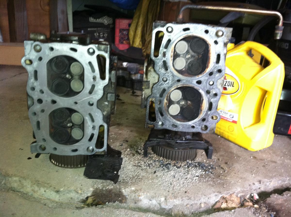

I picked up a 98 legacy with a 96 ej22 with bent valves for dirt cheep and i am looking to hunt down some good remanufactured and or new cylinder heads depending on the cost.
What do you think would be my best value ?
easiest and most practical solution is to install a set of used EJ22 heads - any Legacy or Impreza 1996-1998 EJ22 heads will be a direct swap.
www.car-part.com
alternately you can have a shop simply replace the valves and do a valve job.  that will be $200 - $500 depending what all they do.
generally don't  need a part number for the heads, they'd be killer expensive from subaru.
if it's a 96, your valves shouldn't be bent. 96 engines are non interference. Did the timing belt go? If so, just realign with a new timing belt and drive it.
