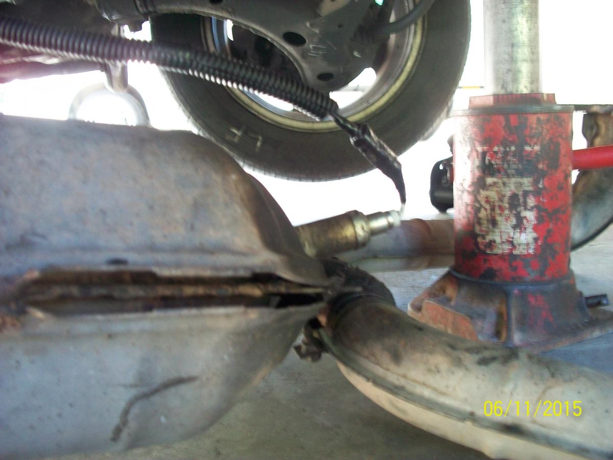

Sticks out of the top left side of the front cat. Kind of points toward the Inner cv joint on that side.
The 02 wires look good all the way to the connector plug-in. The tip of the sensor had a baked-on light tan colored coating like it had been in a industrial oven. The code has been coming back after about one hour of driving. CEL illuminates after a driving cycle is completed.
where is this sensor?  got a pic?
Sorry I forgot to take pics. I'll take some when I put a new sensor in it.
