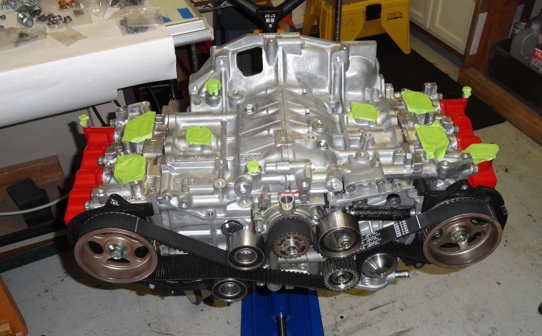

Hi this may seem like a stupid question, to which I have found no no answer... Presumably because anyone thinking of changing their shortblock would want to go UP in displacement in the process, hence all the 2.2 to 2.5 frankendiscussions...
I have an unusual situation because California emissions require that I use an EJ22 block and pre-94 emissions (OBD 1)  for my Vanagon conversion.
I am building an "as new" motor, to last many long years and have purchased a factory Phase 2 Ej22 crate short block and have had the Phase 1 heads rebuilt and a valve job performed to use as a basis.
A 1993 Legacy L donor car and will supply the heads & all the intake & emissions systems as required by CA..
Are there any special considerations to using the phase 1 2.2 heads on the phase 2 block?
 Specifically:
I am aware that the compression will go up and that the engine becomes an interference motor.
Have done a test build of the long block, and timing, and everything goes together fine, Intake manifold lines up correctly, etc...
BUT... are there any "special" considerations??
Phase one, or Phase 2 head gaskets usable?? or modifications to either?
Tweaks or other considerations to correct for the higher compression?
(the motor is self adjusting but, to what limits?)
 Thanks!!!  :D

Use phase 1 head gaskets. The coolant ports on the heads are different between phase 1&2 and the gasket needs to match the heads. Plus the phase 1 composite gaskets just work better. Fel-pro gaskets are the same as OE for the 90-98 2.2 at half the cost.
93 will have the tappet style cams and rockers. You can swap those for a set of roller rockers and matching cams from a later year to free up some extra power.
95-96 if you want to keep hydraulic lash adjusters.
97-98 if you would like solid(screw-type) lash adjusters. There's a minor power advantage to the solid adjusters because of reduced drag on the camshaft while the valves are closed.
Get re-ground cams from Delta and you'll make a few more horses too.

Scooberoo, Thanks for those gasket insights... I used the factory phase 1 gaskets, which looked to be the right thing, because I purchased the whole OEM engine kit out of an abundance of caution. I understand the valve seals and other essential seals last longer if OEM.
Any insights on the compression question? The ECU will adjust for knock, but... should I  just run 91 octane to be sure?

Just noted your cam and rocker insights... we are talking relatively small gains? I assume less than 5 HP?
Do the compression bump and coated pistons take this from 130 up to the phase 2's 140 HP?

Shouldn't be a big deal. I don't remember the exact difference in compression between the two, but it's not like you're going from 9:1 to 11:1.
If you notice any pinging (probably won't) then you might try switching to the next higher grade fuel. Running premium is overkill though unless you have it tuned to really need it.
Ha! That's Cool!!  Been  pumping "required"  91 octane into my Vanagons for the last 18 years. Can you believe... VW built these without a knock sensor!!! Thankfully, Subaru engineers stepped up and built a proper H-4!
The 1990-'96 EJ22 engines were 9.5:1 compression ration.  1997-2002 EJ22s are all 9.7:1 compression ratio.
The early ones were designed to run on regular unleaded, the '97-up on mid-grade.  You shouldn't ever have to go over that.
