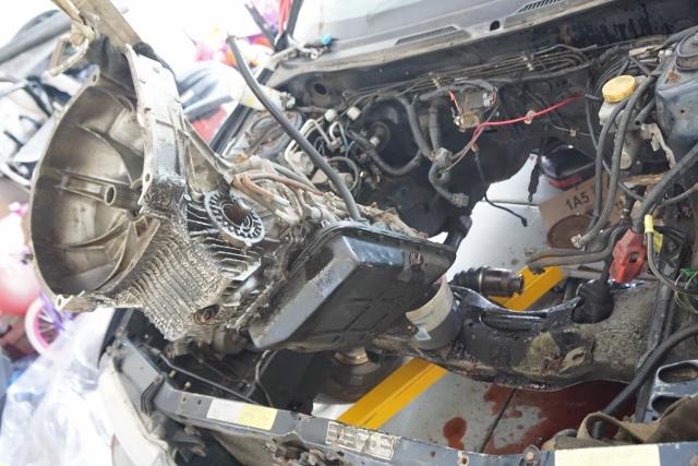

I pulled the engine seperate.  Only took about 15 minutes to split from the trans.  I then disconnected the axles and transmission bolts.  I lifted the trans up with a floor jack on a block of wood then lifted with the engine hoist and started rolling back.  The driveshaft just pulled from the trans.  I have a heavy duty hoist that I picked up this morning for $75 so I was able to get it real high to pull out.  This transmission is heavy.  Personally I would not feel comfortable pulling out from the bottom on jack stands.  I know it would have been quicker but the risk is to great.  I was surprised how much fluid started leaking out as I had this thing airborne. Here is a pic.

well done, that thing almost vertical!
 i've pulled and installed the engine and trans together as a lump multiple times - even on EZ 6 cylinder automatic pigs.  they basically come out like your picture - WAAAAAY up high and nearly vertical to get it all to clear that crossmember.
