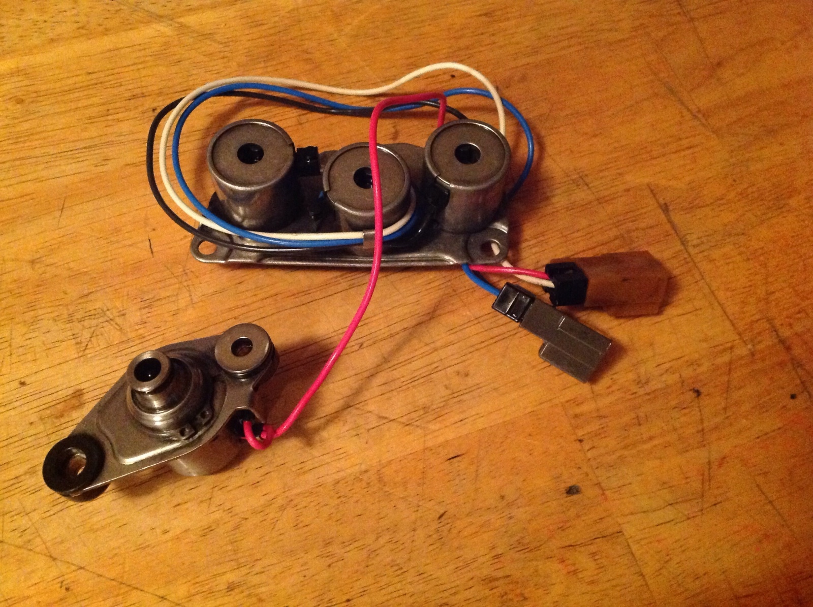

Raul94530 Posted September 11, 2015 Author Share Posted September 11, 2015 This weekend I checked the resistance on Shift solenoid 3 and it was 8 ohms. Its supposed to be between 20 and 32 Ohms.I even Ohmed Shift solenoids 1 and 2 which have the same resistance value and they both came in at 27 Ohms for comparison which is good. From what Ive read the valve body does need to come out to replace the solenoid. Mine is a 1996 Subaru Outback 2.5L. I've seen that some newer models don't require the valve body to be removed to get to the solenoids. But before I do that does anyone know where I can purchase the replacement Shift solenoid 3 other than a dealership. Which I've read sells only the complete valve body. I just want to make sure I have ready access to the replacement before blocking my driveway for the next few weeks. I saw the comment about it possibly being a pinched wire. I would agree but the transmission hasn't been worked on since I replaced the C Solenoid 3 years and 80,000 miles ago. And any advice on removing the valve body. I have the instructions but just wanted to see if anyone that has done this before has any special tips or precautions. Quote Link to comment Share on other sites More sharing options...
Fairtax4me Posted September 11, 2015 Share Posted September 11, 2015 I think solenoids 1, 2, and 3 come as a set. It's a bank of 3 solenoids and I don't remember if they're connected or not. Used is a good option here. They don't fail very often. You may be able to find new ones if you search around. There are a few retailers out there that sell rebuild parts for the 4eat. Quote Link to comment Share on other sites More sharing options...
Raul94530 Posted September 11, 2015 Author Share Posted September 11, 2015 OK thanks you just confirmed what I was looking at. Your right I even called the dealership and they said there was 4 all with the same part number for 350.00 each but I think they mean if one goes out you buy the set of 4. I saw a pic and it looks like a set of 3 and a fourth connected by the harness. This one says its for a R4AX-EL which Im lead to believe is the same or at least interchangeable with my 4EAT transmission. Ill know more by Monday. This will be my weekend project. I have had a bad C solenoid before and have seen lotsa postings about it. But few on this so it leads me to believe your correct that they rarely fail So I might even try a junk yard first about 25.00 for the replacement if I can find one. Ill bring my ohm meter with me to test on site if I can. If not Ebay has this one for 85.00 but would be hard to return if not correct or I now found oneline for 250.00. But your feedback is appreciated in giving me assurance Im barking up the right tree. Thanks again. Quote Link to comment Share on other sites More sharing options...
Raul94530 Posted September 14, 2015 Author Share Posted September 14, 2015 So this Saturday I took down the Valve body. And I did see where 2 wires had the insulation missing in different spots. Soobaroo was right about them rarely failing and a bad wire. I think that's why I had so much trouble getting information on it. Unlike the "C" solenoid which is everywhere. It saved me some money in the end and a trip to the junk yard. So I snipped the exposed wires and put them back together with two butt connectors. I rechecked and the resistance was now OK. They were bare but It didn't look like the had rubbed on anything. I cant tell what caused it. When I took down the Valve body Out came 3 springs and I noticed a rod moving around freely inside. I figured out where the springs go into the accumulators. But I didn't realize what the rod was for. After putting everything together Car started and no Oil Temp light flashing. Only problem was no matter what the car would only go forward. I found a Youtube video that explained that was the Manual control rod. I hadn't connected it to the shift linkage. I took it back apart Sunday and was able to loosen the valve body enough without removing it completely to connect the manual control rod to the shift linkage. And Wallah. Everything is good so far. Shifts smooth. No more hard shifting or AT light flashing. The things that gave me the most help was the description of how to pull the Trans codes. Id heard of the connector under the dash and the handshake. I just had no idea I had to do both. And then the diagram and resistance values helped determine the problem. When under the car I had enlarged and printed out the diagram of the screws I needed to take out the valve body. If I didn't have that diagram it would have been near impossible to figure out as you only need to take out about half the screws. I followed the diagram closely having it on a clipboard leaned on the inside of the tire both times I removed and reinstalled the Valve body. So thanks for the help. My Subaru is back on the road. Quote Link to comment Share on other sites More sharing options...
