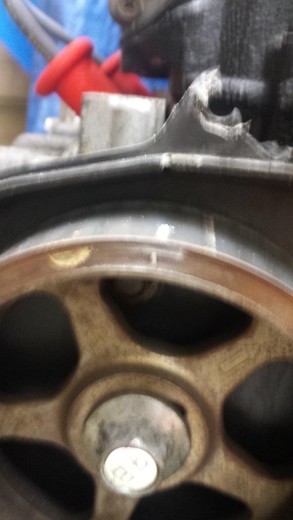

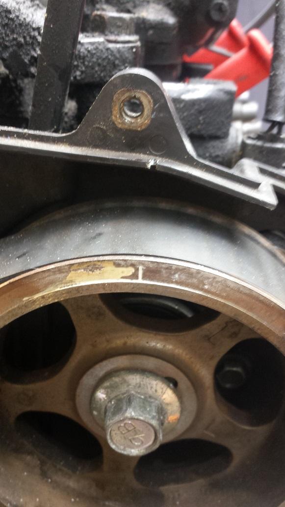

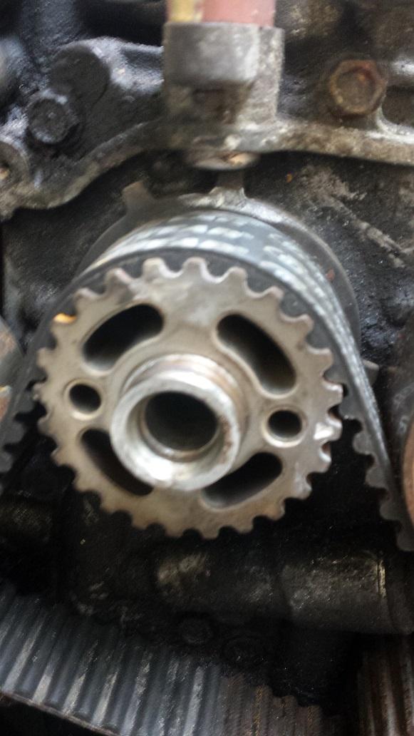

1) Crankshaft / Camshaft Alignment Marks.
If you look at the attached pics when I set everything and removed the
timing belts.   I have the Camshaft alignment marks correct....but the
Crankshaft alignment mark was off.   (Guy I purchased it from had done
the timing belt.
Question:   Should I leave it this  way...or move the crank so the alignment mark is at the 12 position (vs
the 3pm position in the pic).   I guess this did not cause a problem
since it is a non-interference motor?

Crankshaft timing is corret. The timing mark is on the rear of the sprocket. Do not use arrows for timing.
If timing were 90° off it wouldn't run at all.
