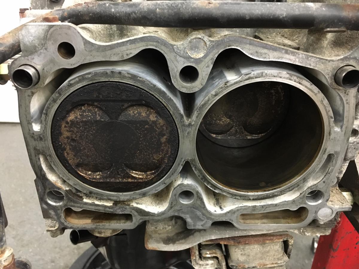

-flat top pistons with machined provisions for valves, as opposed to the dished pistons I've seen in the other two engines

Also, regarding the pistons, I believe the JDM engine also had a slightly higher compression ratio. Probably due to the higher octane fuel they run over there but that's all speculation.
Thanks for the info. I just added some pics of the pistons, makes sense.
