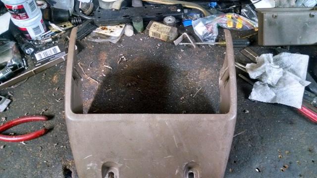

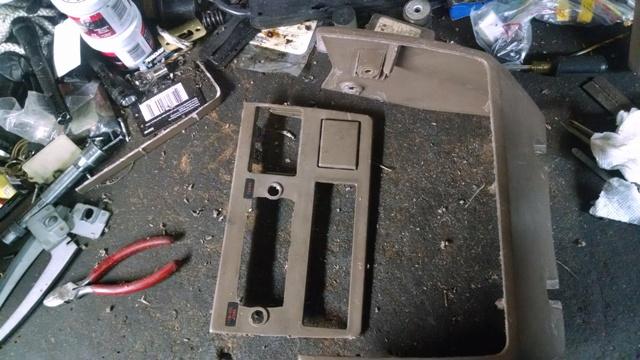

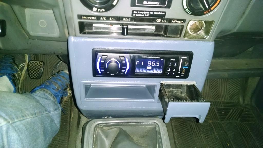

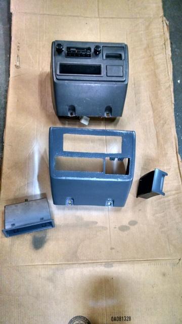

So I got a Boss mechless deck for Christmas to replace my seriously under performing stock radio in my Brat. I had already upgraded the speakers a couple years back as two of them FINALLY began to fail. As many of you know, I'm a purist when it comes to Brats. I won't do anything to a Brat that can't be easily undone, unless said Brat is a basket case. I had a radio console I picked up quite some time ago, that had already been butchered, specifically to install a new head unit. It took some time to get it all done, but now that it is, I've been enjoying awesome tunes for about 3 weeks now. The build....
Thanks. I ran out of black paint twice trying to color match it. The pics make it seem way lighter than it is, but it's only a couple shades lighter than factory.

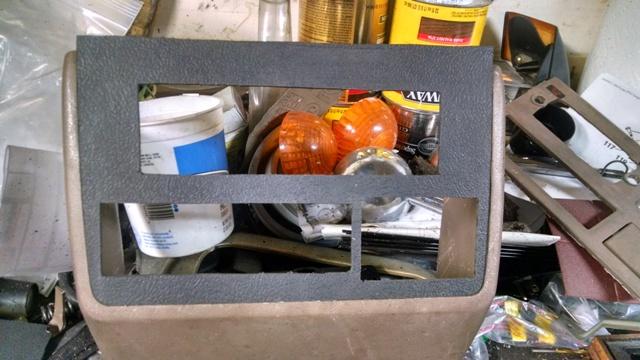

Nice work.  What kind of material is that front face made of?  The part you had cut out for the radio, ash tray, etc.  I'll be doing something similar with my spare console that was hacked by the PO.
That is a piece of the kennel tray from our Great Dane's kennel. lol It's textured like the rest of the interior, so it worked great.
