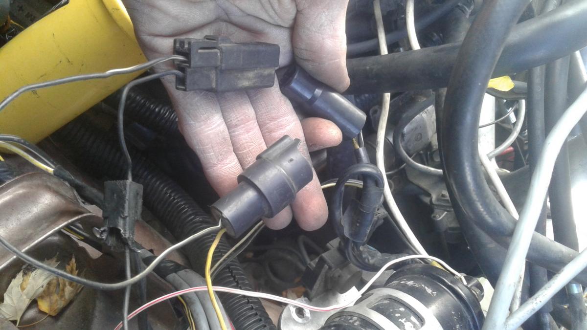

November 2, 20169 yr Author Ok so this plug, in the picture top is bracket side bottom right is harness side and left in my palm is a diode with a plug leading off, this diode comes from the harness side of the plug the other wire from this plug is only yellow, is this the tach signalwire or does the tach just go on one of the post

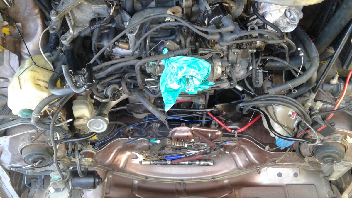

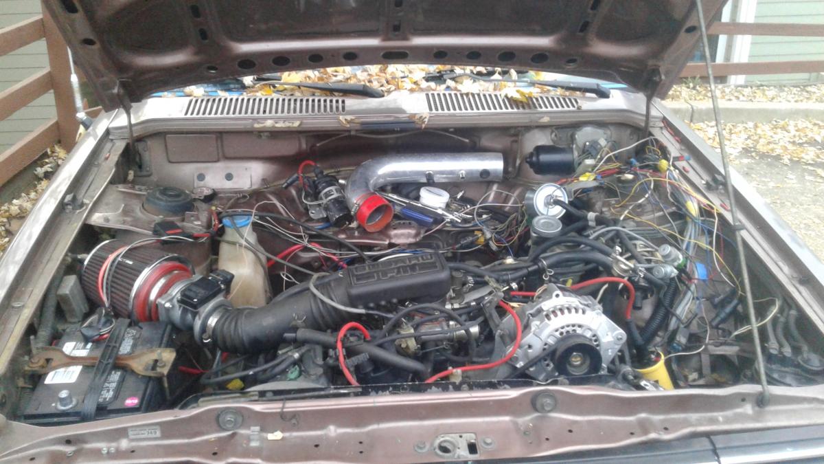

November 2, 20169 yr Author Couple of progress pictures ive taken as i go, so much garbage emissions crap, trying to figure out a permanent intake route
November 2, 20169 yr Author I have spark! It is beautiful, but its backfiring up the intake, im pretty sure my wires are right but am checking against the book, either wrong plug wires or 180 out right? It was beautiful to hear it trying to start, poor beautiful old girl
November 3, 20169 yr Backfiring! ... ... Have you checked if the Spark plugs are wired in the proper order? Kind Regards.
November 4, 20169 yr Author Its running, gotta time it a lil better, but its running, gonna loom it all up and take it for a ride Saturday, so happy, question on the clutch switch, i grabbed a couple whole sourcing parts for this swap and not sure if there is a difference between the clutch and brake pedal switches and if it matters which post ont its plug the neutral switch wire goes to, leaving the other a ground
