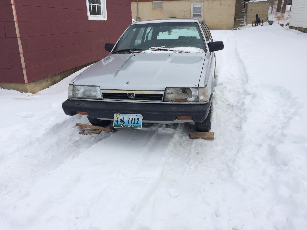

February 10, 20179 yr I havent seen it much, but i have seen a GL wagon with quad headlights and since my new subaru loyale wagon needs new headlights i was wondering if (aside from wiring), will it bolt up? Im heading to the junkyard day after tomorrow and i dont know if i want to use my time removing both good lens and quad headlights from both vehicles if they wont bolt up. Just asking.
February 10, 20179 yr I haven't done it but a buddy did and if I remember it is a direct bolt up other than the wiring. You need all the trim parts including the marker lights and grill for it to look factory.
February 10, 20179 yr Author But it will match up with fenders too? It appears to be the same and i kinda like the quads a bit more, but if if its more hassel or requires a lot of modifications, then id go back in with the glass housings.
February 10, 20179 yr Author I just saw that there is a difference between a DL and a GL. Im still slowly learning about the older subarus
February 11, 20179 yr Pretty sure the fenders are the same. This could be checked by comparing / test fitting a side light from GL to DL. The side lights fit the fenders, and the DL side lights fit to the DL headlights. That's why the other post mentioned getting the whole front, from light to light. I'd grab the harness also, so I could wire up an adapter.
February 12, 20179 yr Author Went to the junkyard and it was a complete success! I grabbed the DL headlights and brackets and side lights. I compared it to another 88 subaru out there with the lenses and it seems to mount up the same. I also grabbed a new tail light too.
February 12, 20179 yr Author I also grabbed the wiring harnesses for the lights as well. Going to have to build my own small harness tor that but it wont be that bad, fairly simple
