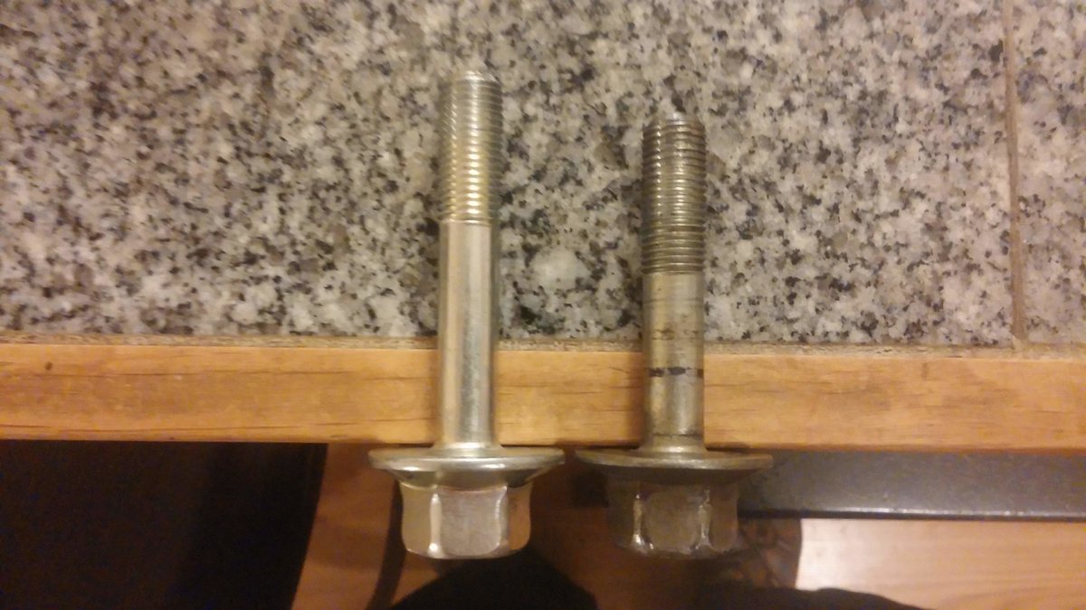

When I get out to the shop later, I'll put a pitch gauge on one and let you know.  I'm guessing 1.25 but we will see.  You will have to find a bolt specialty shop to located that long a bolt IF you can even find one.
Thank you. I only need to find one 10-15mm longer. I am actually wondering if they had the correct bolt on here to begin with so if you could measure how long one is that would be handy too. Thanks

OK pitch is 1.5 , length is 2 7/8" or 73 mm  from seat to bottom of bolt .   The bolt I located was from a 2000 2.5 , it  threaded in to a 2.2 crank no problems. Should be the same but maybe they used a slightly longer bolt on the 2.5 . If so will be easy wrecking yard part.

I just wanted to follow up and say thank you again for the info!  I got the 73mm crank bolt for the 2000 2.5 and wala the extra 6mm  or so was perfect.
I also got a 13mm "bottom tap" to clean up the threads in the back of the hole but it was not needed. My mechanic got it torqued down , he was really impressed. Everyone was thinking the engine was toast or we needed to try one of those threaded inserts.
