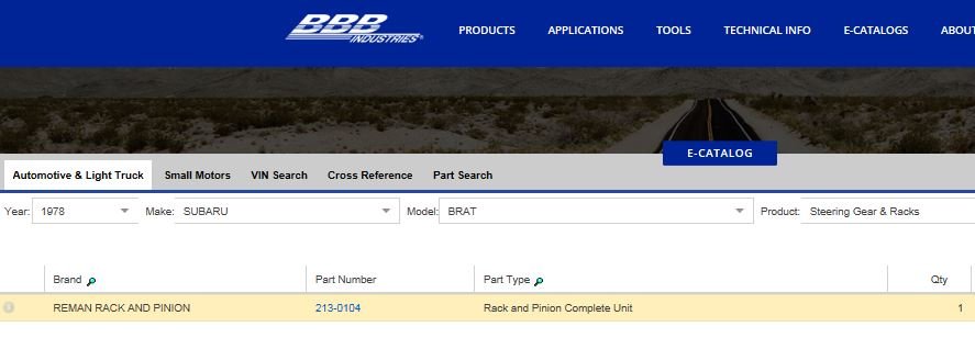

subarujim01 Posted April 12, 2019 Share Posted April 12, 2019 (edited) On 4/4/2019 at 5:29 AM, y22c said: That I may be able to help you with...try ERA Replica Automobiles in Connecticut. They are a Cobra kit car builder and used Subaru 77-79 racks at one time. I heard they have urethane bushings for racks of those years. I need a rack for my Cobra kit car. Ken Yes it is possible to rebuild But I would try Cardone http://www.cardone.com/ first and see if they can do it for you. Also try BBB industries (www.bbbindustries.com) they list a part number 21--0104 rack and pionion assembly. I got one from them (their REMY brand) through "Rock Auto" 2-3 years ago. when I rebuilt the whole front end of my Brat the Steering ,Brakes, Struts, tie rods and bushings etc... lots of fun I had to get creative with the Strut assemblies, I bought shocks for a 1982 brat new coils form MOOG calculated the required size needed and fabed a top cradle to fit the result was a firmer ride, better control, and a system capable of handling more up front weight. I have kept the old one just in case I ever need to rebuild it. Edited April 12, 2019 by subarujim01 Quote Link to comment Share on other sites More sharing options...
