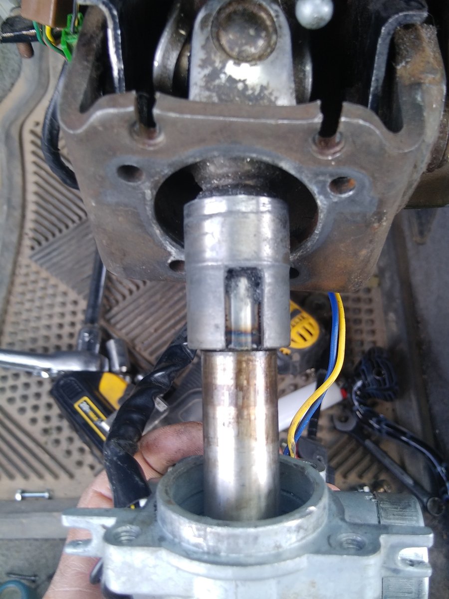

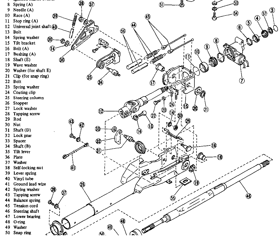

Hello. So I've been pulling my hair out looking for the reason why my BRAT's steering moves up and down by an inch or so. Make a long story short, I've been nickel and dimed out on this issue. In the end I discovered the previous owner replaced the ignition lock. This person must've chucked the old part out to include the rear SPRING, NEEDLE, RACE and STOP RING!!! (parts no. 8, 9, 10 & 11). Buying a new ignition lock did not come with the internals and is not supplied surprisingly. Went to my local junk yard only to be told "...you just gotta buy the steering column  and take it apart at home to get to those parts needed." Paid the $60 bucks only to find out the steering I bought out of an 85 GL had its ignition lock replaced with the same issue of missing the internals. Does anyone know where I can buy these parts?

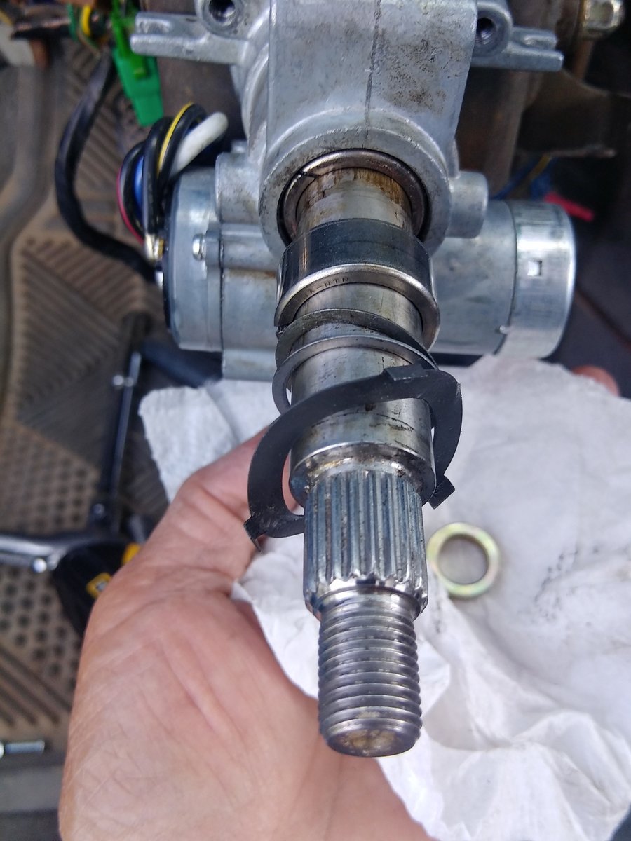

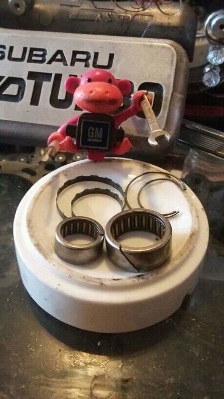

Here's a pic of the parts you sent me. Notice it fits the shaft where the front ignition bearings are. These would be parts number 6, 5, 4, 57 and 3 from my diagram I posted.
Notice the size difference on the steering shaft that occurs inside the ignition lock housing. The rear bearings, parts number 11, 10, 9 and 8 has a larger diameter bearing needed.
Now this is what I'm talking about. Thanks Sparkyboy!!! This fixed the problem
