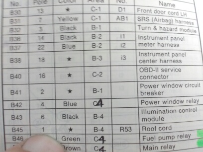

Steptoe's photos Posted Sunday at 11:45 AM Author Share Posted Sunday at 11:45 AM Thanks Ido...you continue to excell yourself with those efforts. Appreciated Sort of going off tangent to main heading but so are the gremlins in my Foz Our EJ202 SF got the ECU as a bolt to the engine block back of #3, but we got those green plugs and black plugs to connect in correct sequence to get something out of the ECU Also have what I thought was result of some mad man settling frustrations out down there - two bare long male pins, black wires. I thought they had been pulled from a plug, but wiring diagram shows and lists them as earths for diagnostics ! I have a few pieces of the AUDM manuals by Subaru for 1998, but mine is MY 1999 so hoping stuff is the same for most of it. I have found the instructions on how to read codes etc via those plugs. Actually plan to get same plugs from a wreck to make up a switch box to plug in down there yet operate from the pilot's seat for human comfort sake ! And not trying to correct anyone or anything on OBDii compliance or convenience , I wonder if manual has more differences than what I have found so far .... Quote Link to comment Share on other sites More sharing options...

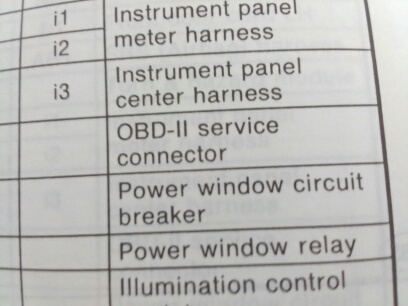

Steptoe's photos Posted Sunday at 11:50 AM Author Share Posted Sunday at 11:50 AM bigger shot of the page Quote Link to comment Share on other sites More sharing options...
