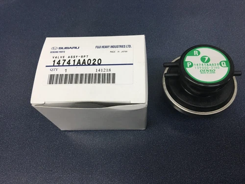

FWIW:  I replaced the BPT - back pressure transducer - that sits on top of the EGR valve and has 4 vacuum lines connected to fix my p0400. These are readily avl. on most EGR subarus from the '90s and Toyotas - I used a  (used) Toyota version on my '96 Legacy w/the 2.2.
Genuine Subaru Vacuum Solenoid Modulator EGR Valve Modulator 14741AA020 OEM - Picture 1 of 1
