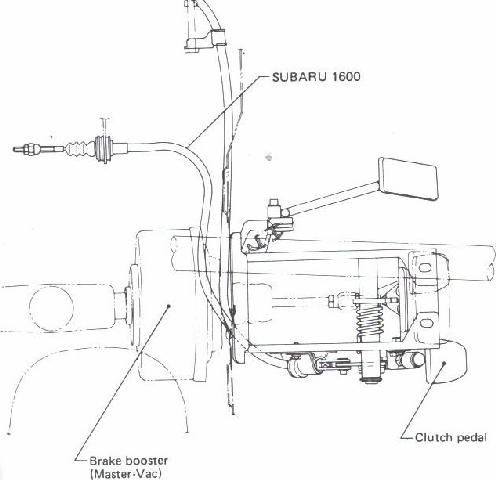

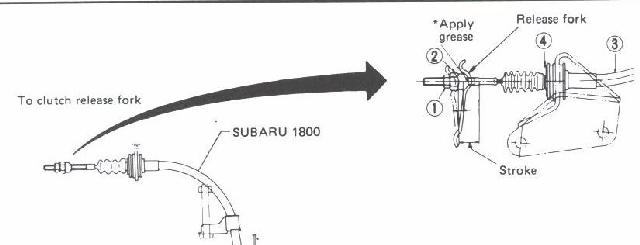

December 5, 200520 yr hey there.i need help hooking up my clutch cable in my 85 gl wagon.i have the cable going thru the firewall but dont know how to connect the two ends.the car was just given to me so i didnt take the old one out.is there anyway you could give me instructions on how to do it or send me the diagram.any help would be greatly appreciated.thank you. Update: I replaced the clutch cable, and it feels fine now. Guess I just had an old stiff one.
