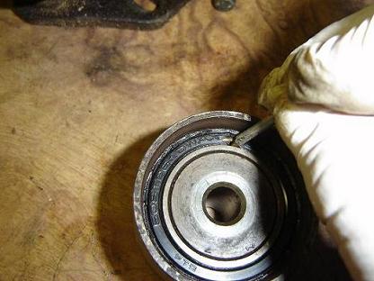

The bearings have a thin metal cover over them to retain the grease and protect them from water and dirt. The idea is to pry back this cover as little as possible in order to insert a grease gun needle into the bearings. As in the first picture, gently wedge a nail (or equivalent) into the inside of the bearing cover. Use as little force as possible to gently lift up the cover. It is better to keep missing it because you're not deep enough or pushing hard enough until you get it just right than to overshoot your mark and damage the cover. The needle is very small and wedged shape itself, so you won't need much room to work with to get it in there. Do not pry up excessively, the bearing cover can and will come up with excessive force (more on this later).

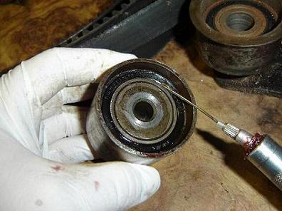

Have your grease gun packed with high quality grease for this application and a grease gun needle as pictured in the second picture. Insert the tip of the gun under the cover at an angle as shown. You won't go deep as the bearings are in the way, but you can go under the cover further. AFter inserting the needle, keep it flat against the pulley and use your finger to press tightly against the needle entry area to prevent grease from coming back out as you pump the grease gun. I think *roughly* 2 good pumps in with my grease gun set up works well. Pump the gun once, then take the needle out and rotate the bearing around. Attach it to a drill or just spin it by hand is fine as well to spread the grease around the bearings. Then insert the needle and repeat the procedure again. I would use as little grease as possible to tighten up the pulleys and make them feel smooth, one pump will probably do, though i've used more in mine. Again, keep adding little bits at a time until it feels good and smooth.
This is important - Don't pump too much grease in. As mentioned before the cover can come off and continued over pumping of the gun can and will push the cover off the bearing as well. Also if you put excessive grease in, it will start to come out of the pulley after the car is in use for awhile, the high RPM's and forces will heat the grease and push it out. That's not necessarily bad except that the grease could get on the timing belt and it just gets messy and looks funny. You will hear "popping" noises as the air bubbles are pushed out and moved around, that is normal. You may also see nasty brown grease come out around the edges or backside of the cover, this is the old grease/water/dirt coming out. Usually not much comes out, but I have had a couple do that and that's good to get that out but they are all that bad.
