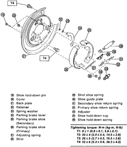

Plus then you need all the parking brake stuff, shoes, springs, etc.
anyone post a picture or FSM diagram, i'm not picturing where these go since i'm used to old generation stuff. i understand it's a separate mechanism and that's about it.
Link to comment
Share on other sites
Sure, looks something like the attachment (this is for 1996 Legacy). None of those parts are too expensive brand new, but the adjusters were like $20 each I think. $65 or so for a parking brake kit including shoes for both sides. Springs and stuff were a few $ each I think.

Yes, you need the ebrake parts from the disc equipped vehicle, the springs, cups, hold down pins, pads, etc. The disc brake parking brake is esentially a drum brake inside the disc, completely separate from the caliper and disc pads. Whereas the parking brake on the drum brake just uses the regular drum brake pads for braking and parking function.
That pic I attached in post 4 shows just the e-brake components. Then the rotor goes over that, and the caliper and bracket and disc pads are over that.
