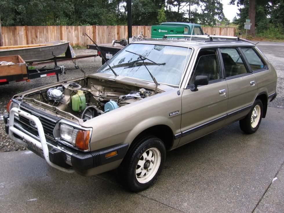

Hey Caboobaroo, Worked out very well. Thanks. I had to do it twice 'cause the master cyl. rod has to be attached to the brake pedal BEFORE the cluster is attached to the firewall. Also, the clutch cable should be attached to its pedal as well. Much easier that way. I'm going to reseal the ea81 this afternoon, maybe drop it in tonight. You can barley see it in the pic, but this paint job has a really cool pin stripe inbedded in the paint. When I'm done with the swap, Im going to find someone who knows how to ride a buffer and see if they can bring it out more.

Glad everything worked out for you. I figured that since you had the parts car, it would just be easier to swap the two pedal clusters instead of trying to modify the one that you had in the car to work with the clutch cable.
Its kind of funny, but I was thinking about you doing this swap in my head, and realized this was going to be a hold up on it. I was about to pm you to tell you what you'd have to do... But I see it has been taken care of...
BTW... That is a really pretty wagon.

I gotta tell ya. I have been looking at subaru wagons for days and days now and I also think mine is a very nice looking one. It sat for a couple years under a tree down in Lewis county. Needs a serious cleaning inside and out but that can wait.

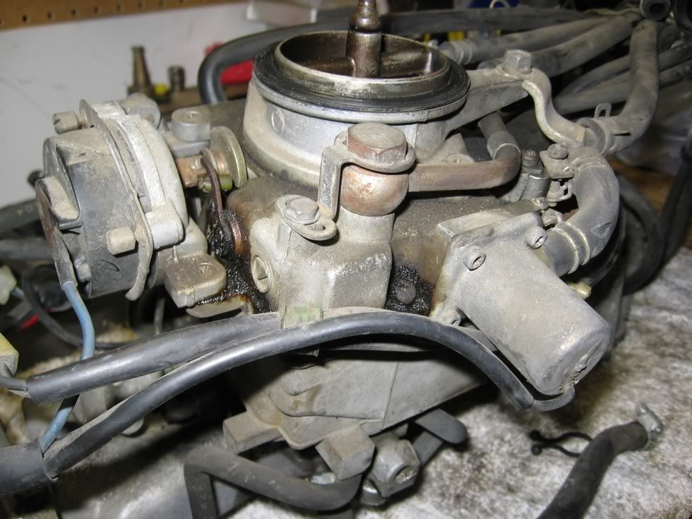

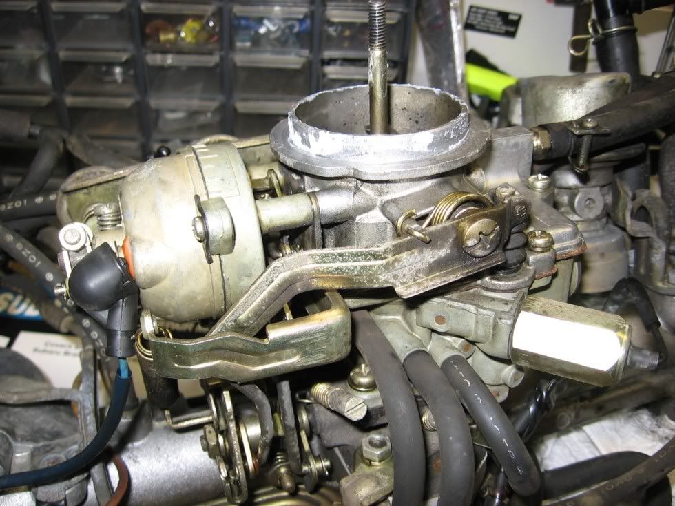

I pretty much have everything installed except the intake manifold. I thought i might be able to, in order to solve some of my connecto problems, use the old ea71 intake and carb on the new ea81 motor, but as most of you know, that aint gonna work. So, my next thought was to just switch carbs, but they mount up diffrently. I'm kinda stuck. Can i eliminate some of this emissons stuff?
The first pic is of the original ea71 carb.
The second one is of the ea81 carb. Says carter/weber on it.

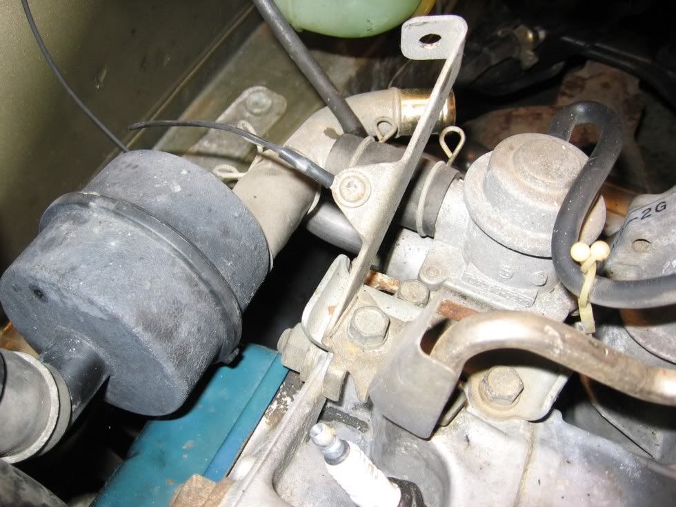

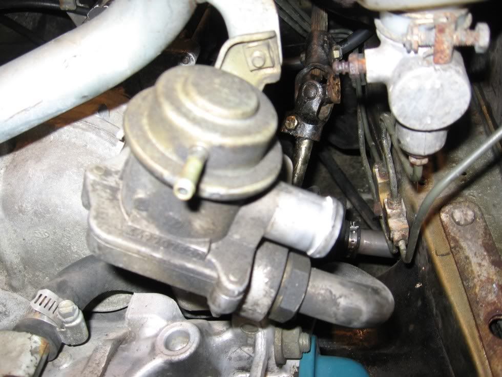

The last two pics are of things connected to my engine that I would really like to get rid of. Any ideas appreciated...Thanks.

but the 4wd parts car should be standard hitachi carb. You may have to do a little swapping here and there between.
I missed this somehow. And yes, it looks like the hitachi from the ea71 will bolt right onto it and then I can mount it all onto my ea81. Or, maybe the carb thats on there now will be more compatible than the carter/weber.
I have read a few threads about removing emissions equipment and keeping the stock hitachi carb. Seems its very doable. For the most part, remove or plug everything except vac. advance, brake booster vac and heater ducts vac.
