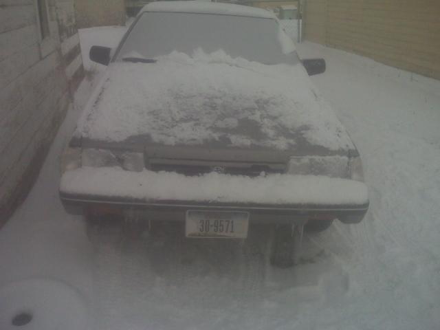

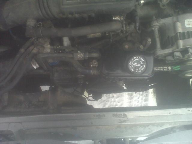

whalla! heres my car i am working on :headbang:
my pic is not that great, taken from my phone... wish i could do better
Edited by soobies, 30 December 2010 - 01:39 PM.

Yes, your Engine is Missing some Parts, let me explain it Better...

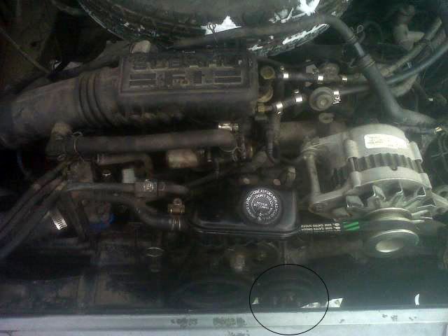

...Look at the Round Circle I Drew in your Picture:
Posted Image

There, in those four Screws, a Clutch fan must be Placed. is Missing.
You can grab one at a Junk Yard, along with its Cover.

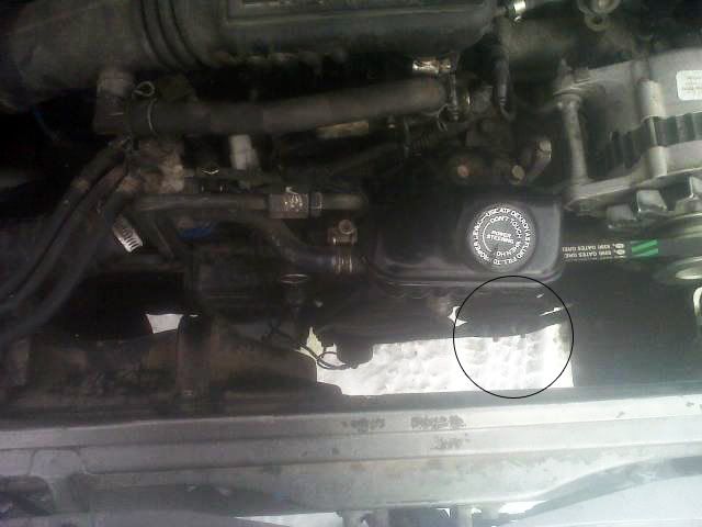

Here, a More easy-to-Look View:
Posted Image
Around all Empty area goes a Fan Cover for the Missing Fan.
Posted Image
gotcha.. im heading to the junk yard to find one that is probably why i am overheating
