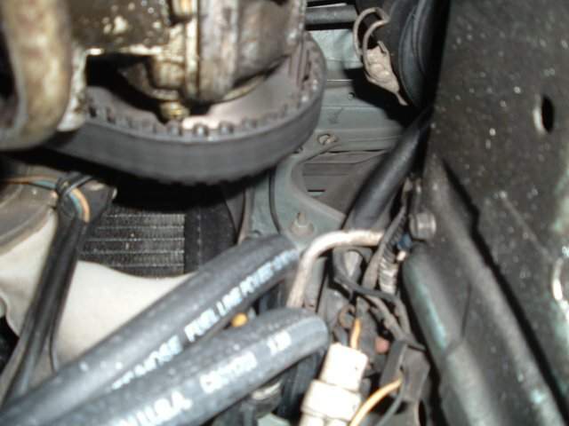

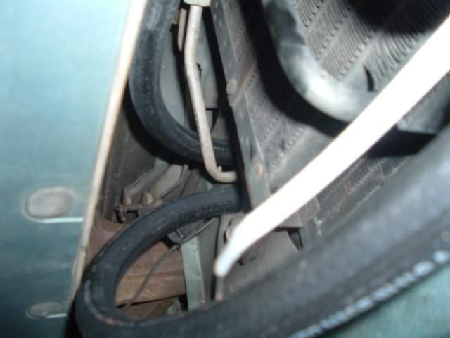

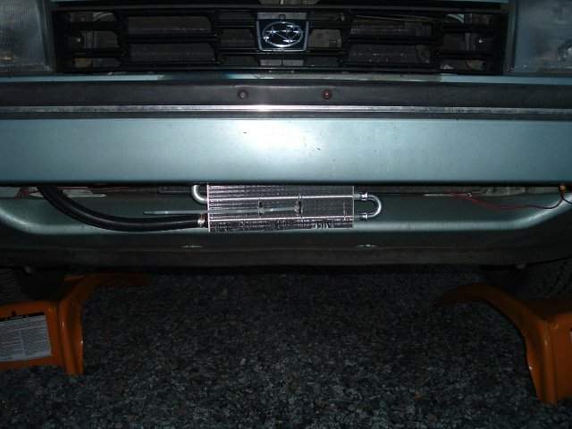

OK! Heres what I did....lemme find the pics....
Yes, i used a trans oil cooler as well.

dam is that one of those externaly lubricated motors?:eek:
seriously though I see what you have going there. thats along the lines of my plan #1.
I think my cooler is more restrictive than that one. a limited flow ability thru the cooler should not affect the vehicles Oil pressure or flow right?
oiling systems make me nervous. just want to do it up right.

it will create more pressure, as resistance to flow is pressure. You want the cooler setup to flow as freely as possible...which mine does not...as i would like to have AN fittings and a slightly different cooler core...but ti works fine.
And I did have some leaking issues...just make sure everything is tight.

I used some 1/2 fuel line good for 300 PSI, and the trans oil cooler I am using is IDENTICLE to the engine oil cooler that hayden sells...BOTH are rated at 300 PSI.
BTW: Hayden automotive makes these adapters and coolers that i use.
