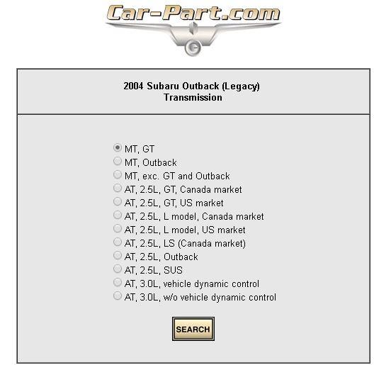

wtdash Posted September 7, 2016 Share Posted September 7, 2016 (edited) Welcome to the USMB, car-part.com will show 'for sure' interchange. but you (and we) also need to know the engine - 4 or 6, Manual or Automatic, and the trim level - Limted, LL Bean, VDC, etc. Td Edited September 7, 2016 by wtdash Quote Link to comment Share on other sites More sharing options...
CNY_Dave Posted September 7, 2016 Share Posted September 7, 2016 Assuming auto, in general you can use a 2001-2003 (in addition to '04) with perhaps changing a solenoid and valve in the tail section. When I did a swap of an '04 LL bean 4EAT into an '03 LL bean, the interchange they used wrongly stated an '04 would swap right in to an '03. Hollander actually updated their interchange manual based on my info! Quote Link to comment Share on other sites More sharing options...
