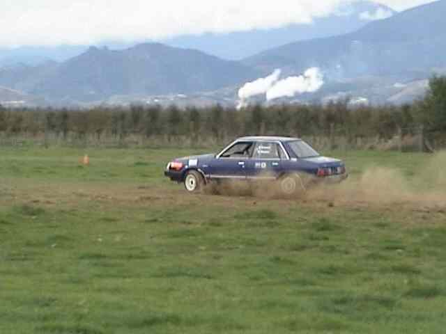

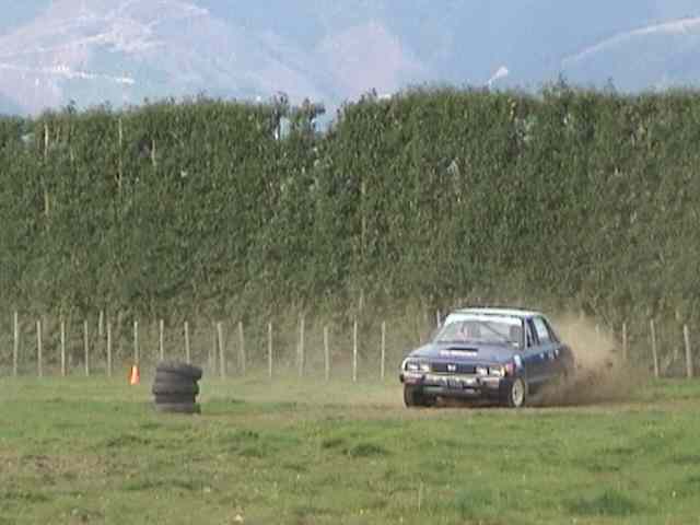

EA82Turbo Posted August 16, 2005 Share Posted August 16, 2005 Hi, Had a big crash in my Leone and having problems finding parts. Need to know what model/series this car is? EG: L series??? Car is an 1982 Leone 4x4 turbo. Have attached picture. Hardnest part to find is the axel shaft. Managed to snap mine in half. CVs are easy to find. Seems to be a funny shaft. Its about 450mm long, 210mm between small end of CV boot, 26mm wide and has 23 count spline at each end. CV at gearbox end has 23 count spline and CV at hub end has 30 count spline with 58mm seal size. Gearbox is hi/lo 4wd and 2wd selectable, 5 speed originally attached to an ea81T but now attached to ea82T. I'm not sure which parts are standard on this car. If any of these measurements make since please let me know which model/series my car is and which model/series the axel shaft I require comes from? These cars are getting old!!! very hard to get parts from!!! Better drive carefully in the future. Thank you for your help. Quote Link to comment Share on other sites More sharing options...
Subsforever Posted August 16, 2005 Share Posted August 16, 2005 Car is an ea81 with an ea82 engine and transmision, i dont believe they had a 5 speed duel range tranny until 85 on the ea 82's, before that they where 4 speeds. I think that you would use the axles for an ea 81 becuase the ea 82 was a wider car so had longer axle's. Quote Link to comment Share on other sites More sharing options...
Ross Posted August 17, 2005 Share Posted August 17, 2005 Hi, Had a big crash in my Leone and having problems finding parts. Need to know what model/series this car is? EG: L series??? Car is an 1982 Leone 4x4 turbo. Have attached picture. Hardnest part to find is the axel shaft. Managed to snap mine in half. CVs are easy to find. Seems to be a funny shaft. Its about 450mm long, 210mm between small end of CV boot, 26mm wide and has 23 count spline at each end. CV at gearbox end has 23 count spline and CV at hub end has 30 count spline with 58mm seal size. Gearbox is hi/lo 4wd and 2wd selectable, 5 speed originally attached to an ea81T but now attached to ea82T. I'm not sure which parts are standard on this car. If any of these measurements make since please let me know which model/series my car is and which model/series the axel shaft I require comes from? These cars are getting old!!! very hard to get parts from!!! Better drive carefully in the future. Thank you for your help. Originally, that would have had a crab'd engine and 4 speed manual. What you want, as mentioned before, is axles off any old ea81 4wd car (pre '85)(not L series). Try Rossco's wreckers in Ashburton if you are stuck. Quote Link to comment Share on other sites More sharing options...

Qman Posted August 18, 2005 Share Posted August 18, 2005 The VIN number will tell the whole story. Non-US spec cars are different than US spec but I will try to field this one. EA81T car that originally came with an auto. The 5 sp would have been attached to an '84 and newer car down there('85 and newer in the states). The turbo axles have a larger diameter shaft but the cups should be the same for all. As long as they have 23 splines any will work. Post the VIN and we may be able to decifer it to tell the original story. Quote Link to comment Share on other sites More sharing options...
