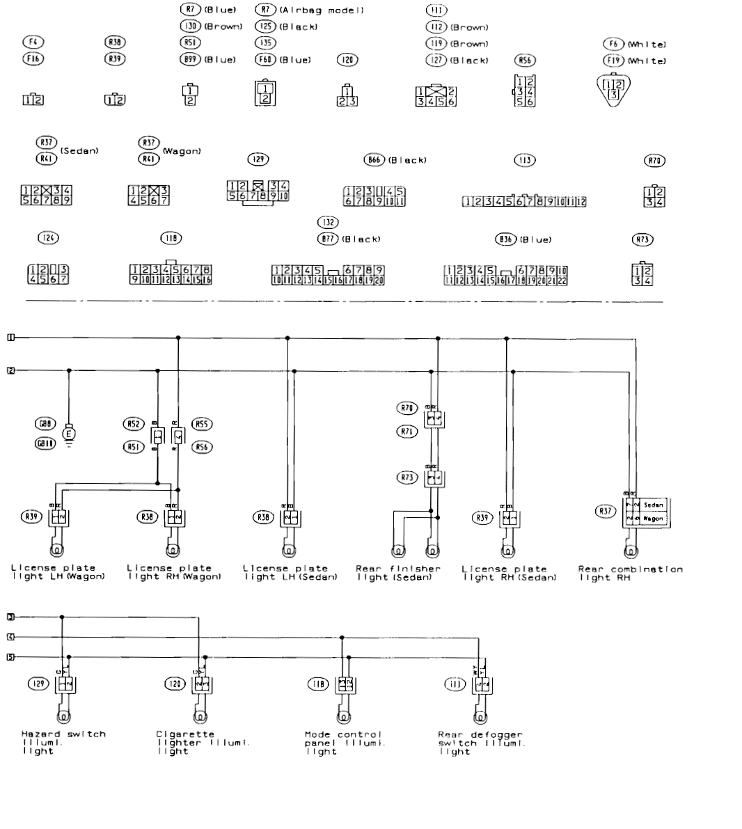

Not sure; here's some related '94 Legacy wiring diagrams... I would double check that fuse 5 with an ohmmeter or just replace it to see if that helps; it seems that is a common fuse for many of these lamps.
