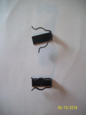

AEROCOOK replied to AEROCOOK's topic in 1990 to Present Legacy, Impreza, Outback, Forester, Baja, WRX&WrxSTI, SVXWell it cost me 6 bucks but I now know what the mystery part is. As you can see in the picture, the part was just spread / bent apart which is why I couldent find anything that it fit onto. The picture shows the original one next to the new one. I ordered the part because based upon the part schematic in the manual, there was a part missing in my tranny. I was hoping the missing part would solve the mystery and it did. Many thanks to nipper for providing me with the service manual pages.

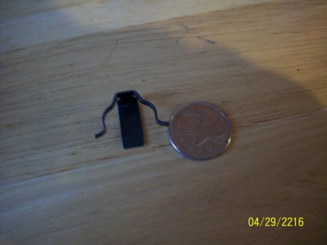

Hi all. Been away a while because I wasn't driving a Subaru, but I picked up a 97 Outback recently so Im back. Here's my dilema... while replacing the shift cable I managed to bend a part inside the auto transmission, it is the part that engages the manual valve in the valvebody and also attaches to the park pawl rod. I removed the tranny pan to inspect and repair and I discovered a spring clip in the bottom of the pan. I believe the clip likely fell of at the same time as I bent the other part because the clip is steel and if the vehicle had been driven with the clip in the pan it would have likely found it's way to the magnet but it hadn't. So, can anyone identify this clip and tell me where it goes?
