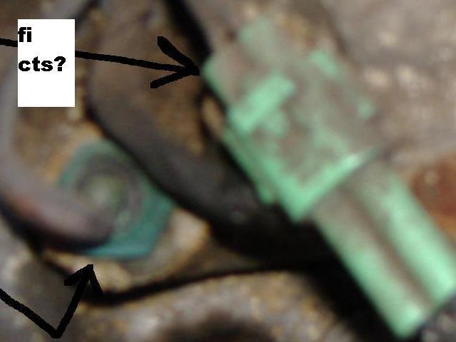

  4. I installed the new temp sensor tonight and guess what....... my Loyale started right up so fast I'm surprised how that little sensor fixed my start problem. KUDOS TO SKIP THANK YOU SIR BRUCE
  5. ok here it is 45 mins out in driveway, hood open, winds gusting to 30mph, 26 degrees here 9,500 ohms ??????
  6. Just did some leg work, or should I say " let your fingers do the walking"? I called 2 auto stores and they said NO to carrying the sensor. I called my local subaru dealer / parts and have one on order. Lists for $81 but since I've bought alot from, I'm getting it for 65. I'll wait till close to 6pm and test again
  7. Sorry SKIP, I'm in hyper mode with the cold / dark to get this figured out. I asked the questions before I noticed everything on the wonderful chart you posted, my mistake Bruce
  8. Just got a 0.6 x 10k or 6,000 ohms at 5pm. I assume if let sitting till , say 5:30 or 6pm, ohms should go up. Contacts in that green connector look real clean should this check out ok,??????
  9. if engine is warm/hot, what should multi meter show? ohm value or on/off. i've had car running and now is too hot to remove sensor for testing. but if i wait hehe it'l cool quick realy windy cold here:mad:
  10. is it the green connector in the picture (hope it posted) or what it's connected to at the perceived themostat housing. It has 2 wires to it. The other is a single wire going to another area close by Can I remove the sensor without loosing too much antifreeze? The picture is poor due to limits here on size.
