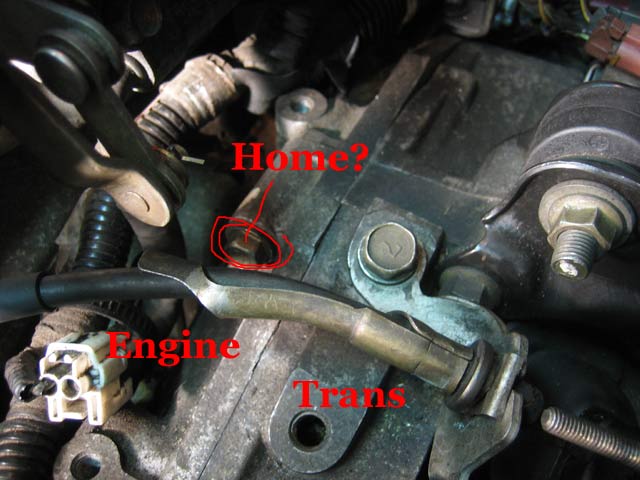

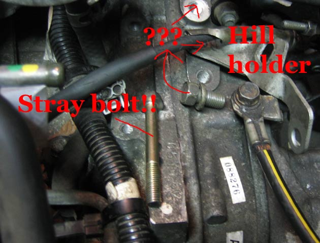

Clutch job done, but now the mystery bolt game begins...
wondercow2 replied to wondercow2's topic in 1990 to Present Legacy, Impreza, Outback, Forester, Baja, WRX&WrxSTI, SVXWhoops! Well, it's now so hopefully my block doesn't fall apart down the road at an inconvenient point...
wondercow2 replied to wondercow2's topic in 1990 to Present Legacy, Impreza, Outback, Forester, Baja, WRX&WrxSTI, SVXI think I found it- it's 12mm bolt, actually smaller than the 14's that hold the bellhousing and engine together. I have no clue what the hole the bolt fits in is for though! But it looks like it fits, and it does give me a sense of deja-vu, since I remember being perplexed when I took something out of there.
wondercow2 replied to wondercow2's topic in 1990 to Present Legacy, Impreza, Outback, Forester, Baja, WRX&WrxSTI, SVXWell, I KNOW it's not a pressure plate bolt- I very carefully installed and torqued them. A very long bolt (same size as the starter bolt) holds on the bracket on the passenger's side. There are a few threaded holes in the top of the block, but none of them look deep enough for the mystery bolt. Thanks all the help so far.
wondercow2 replied to wondercow2's topic in 1990 to Present Legacy, Impreza, Outback, Forester, Baja, WRX&WrxSTI, SVXWell, I've got that one- it's much longer than the bolt in the picture. (btw, did you notice if your car had that bracket labeled "hill holder" on the starter bolt??)
I finally got everything back together on my poor Legacy, but I have one important-looking bolt left over that was in my "engine-trans" parts container. I don't have any clue where it goes! Also, I'm having doubts about the hill holder bracket- does it really go on the starter along with the ground cable? I'm kicking myself for not taking photos while tearing it down...
Help! Engine-to-bellhousing bolts- where are they?
wondercow2 replied to wondercow2's topic in 1990 to Present Legacy, Impreza, Outback, Forester, Baja, WRX&WrxSTI, SVXUpdate: used some gentle prying to separate the two pieces, but now I need an engine hoist. The oil pan is too lumpy to balance a jack on (even with a block of wood), so it's impossible to keep it level and move it back toward the radiator at the same time. I got it jacked up far enough and held far enough back with a come-along to get the clutch and flywheel off, but there's no way I can put the engine back in this way. Off to the machine shop and tool rental place tomorrow...
wondercow2 replied to wondercow2's topic in 1990 to Present Legacy, Impreza, Outback, Forester, Baja, WRX&WrxSTI, SVXThanks for the tips. I've got new clips on order at the dealer already along with a separator plate and main seal. I'm attempting the move-engine-forward route, but if it's not working I've got all week to drop the transmission. It was pretty easy getting everything off up front, and there's a ton of room to slide the engine forward. Just need to break the bloody transmission off now (off to spray more PB Blaster). Are there any particular places where I can give either the transmission or engine a good whack? Any special tricks? I was thinking about reinstalling the pitch stopper and using that to pin the transmission down while I genlty jack on the oil pan to try and get some pressure on the mating surface, but I'm worried it might easily snap a pin or something.,
I'm mid-clutch job, and hoped to have this done by tonight but I can't seperate the engine and trans. I have removed the two nuts on the bottom of the transmission, a long bolt holding on a bracket on the passenger side top, the long starter bolt (other starter stud is still in- does it need to come out? the nut is already off). I'm taken off some other smaller bolts from the topside that go in vertically, but they look like they just hold in brackets. Am I missing one? I read in several places that there were 6, but by my count I've only got 5?? :-\
