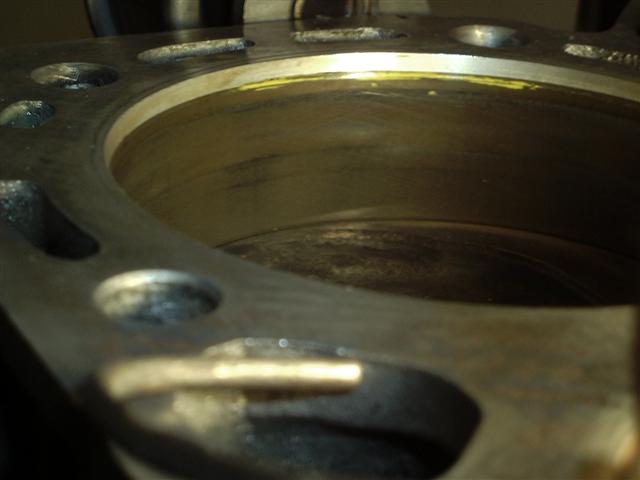

  3. Yup thats the spot, where the sleeve meets the top of the cylinder. Yeah Gary this is the motor that blew them before and there wasnt a 6pk involved this time. Only do that for the cutting. lol There is a really fine 1/4 crack or rough edge where the sleeves top is. Guess when I get the heads back I will put it all back together and try again. Have no idea why the bolt came loose either. Going to try a different torque wrench this time too. My snap-on was recal'd 2 yrs ago but it's older then a lot of the guys on the forum. Will let ya know how it turns out. Wish me luck this time. lol

  5. Ok, tried the picture a couple more times. Only way I could get you an idea was to mark it with a crayon. If you look on the leftside of the yellow you will see a rough gap. It's not much but you can feel it with your fingernail.
  6. Well I tried taking a picture but you cant see it. It looks like the top of the sleeve isnt prefect against the lip. The guy at the machine shop gave me a thick bar to check the top of the block with and I can not get a .002 feeler under it anywhere. I have done this motor acouple times now and the last mess before this was created by me using one of those brillo wheels on a drill to get the gasket material off. I messed the heads up and he milled them again for me. It went 1500 miles and blew the gasket. When you start the car and pull the rad cap cold you can see the pressure pretty easy plus it is smoking. After the car gets warmed up it's harder to see and the smoke stops for the most part. It sucks the overflow bottle dry in 15 minutes thou. Guess I will just put it back together one more time before I give up on it. I did find a loose head bolt when I went to take it apart. I checked to see where they were at and at 40lbs I went half a turn with the torque wrench. This loose bolt is the short one in the middle of the head right above the exhaust outlet. Ther rest of the bolts were at 55lbs where I had them. I also bought new bolts from Subaru and the washers to reassm this time. Well wish me luck. I sure need it.
  7. Ok, since I have the motor apart again for the third time I am looking it over top to bottom. Cant see any cracks in the heads. No ridge in the cylinders at all and no cracks that I can see BUT.... On the very top of the cylinder I can see a little crack where the sleeve comes up to the top of the block. Now my way of thinking is this isnt a problem because the sleeve is pressed on from crank side out and the little crack I see does not go thru into the water jacket. It looks like there is atleast a ¼ inch all the way around the sleeve and no cracks. I have never had the sleeves out of a block but I know they are just pressed in and I dont think this is it but thought I would ask. It anything was getting into there and behind the sleeve it would end up in the oil and not in the water jacket. Sparkplugs were all clean and the top of the pistons all looked the same. Sorry if I'm boring you guys but I want to make sure I'm not missing anything. I did have a loose headbolt, the one right in the middle of the head above the ehhaust outlet and that one was wet. Other head exhaust outlet was dry. So it's on the passenger side whatever it was. Block is flat and I'm having the heads pressure tested again. The car ran 1500 miles before it blew the head gasket. I also bought new head bolts this time and I have cleaned the bolt holes out with brake clean. I am using Felpro pt head gaskets also.
