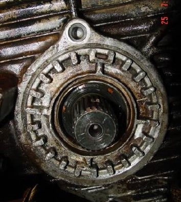

What tool to get retainer off axle stub shaft?
Kilroy replied to porcupine73's topic in 1990 to Present Legacy, Impreza, Outback, Forester, Baja, WRX&WrxSTI, SVXThe oil that I have leaking is definitely differential oil, not engine oil. The oil is a golden colour and quite thick.
Kilroy replied to porcupine73's topic in 1990 to Present Legacy, Impreza, Outback, Forester, Baja, WRX&WrxSTI, SVXSeparator-cover leak? More info please.
Kilroy replied to porcupine73's topic in 1990 to Present Legacy, Impreza, Outback, Forester, Baja, WRX&WrxSTI, SVXI can see the seal and it looks perfectly fine, but it does slowly leak enough to be a pain and it's quite smelly every time I stop due to it burning on the exhaust. Breaking the retainer isn't an option (I don't have another to replace it), I would rather just live with it the way it is. I'm thinking that the retainer is corroded enough that it has become one with the casing. I'll be calling Subaru in the morning to verify that it's a righty-tighty thread.
Kilroy replied to porcupine73's topic in 1990 to Present Legacy, Impreza, Outback, Forester, Baja, WRX&WrxSTI, SVXI've remove the locking clip, with the amount of force I've put on the retainer I think I would have bent the hell out of that clip even if it were in place. I tried turning clockwise as hard as I could once, just in case it was a left hand thread. It didn't budge. That was also my concern with the PB Blaster, that being vertical it wouldn't soak into the threads. The only way I can overcome that is to put my car on it's side, not really an option.
Kilroy replied to porcupine73's topic in 1990 to Present Legacy, Impreza, Outback, Forester, Baja, WRX&WrxSTI, SVXI can't see using a screwdriver, let alone two of them, to remove the retainer unless the diff is outside of the car. There is very little room to work and no room to work with any leverage flat against the retainer. Someone mentioned that the axle stub just pops out, I put a long screwdriver through the spring pin hole on the axle stub and pulled as hard as I could, no way was that stub coming out. I created a tool to spin the retainer while at work today. I took a 3" piece of 3.5" diameter (the same diameter as the teeth on the retainer) stainless pipe and welded 3/16" stainless rod on the outside of it at 0, 90,180 and 270 degrees. I left the rod sticking out about 1/4" and then hammered them over the edge of the pipe at 90 degrees. I then tacked a 3/4" size nut onto the center of a 3.5" square piece of stainless and tacked the square piece onto the opposite end of the pipe so I had something to attach a tool to. The tool fit nicely over the teeth with all 4 of the teeth on the tool engaging the retainer. First I tried to use a small crescent wrench to turn the nut, then a large wrench and finally a 1/2" ratchet with a 3/4" socket on it. No way that thing wants to turn, I was pulling as hard as I could on the ratchet! I've just soaked it with PB Blaster and in a couple of hours I'll soak it again before I go to bed. If it still won't turn in the morning I may try to put the ratchet handle vertical and attach a snipe to it, but this much torque may be enough to shear the teeth on the retainer. What a pain this leak is turning out to be, if the damned thing would come off I could finish this and have it back together in 1/2 hour!
Kilroy replied to porcupine73's topic in 1990 to Present Legacy, Impreza, Outback, Forester, Baja, WRX&WrxSTI, SVXHere's a site that suggests using a piece of PVC to make the tool: http://www.ford-trucks.com/article/idx/9/052/article/Dana_44_Front_Axle_Shaft_Ujoint_Replacement_.html I'm concerned that PVC will break too easily.
Kilroy replied to porcupine73's topic in 1990 to Present Legacy, Impreza, Outback, Forester, Baja, WRX&WrxSTI, SVXI'm replacing that same seal today, as well. I have everything apart and am stopped at that retainer. I tried to tap it with a long screwdriver to start it turning (after marking it to get it back to correct position). A couple of firm taps and the 'tooth' broke off, as I feared. The seal came with an o-ring as well, it will fit behing the retainer. Now I'm calling around looking for a place that has a tool lend program (PartSource, Canadian Tire, etc.) in the hopes I can find something to get the retainer off. If all else fails, I'll grab a 3.5" socket from work tomorrow and put some cross cuts in it until it fits properly.
