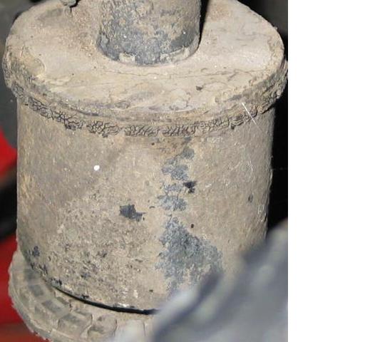

  6. I think I found the culprit. I discovered that the differential carrier bushing is pretty eroded (see picture). Does anyone know of a good source for a replacement? I understand these are pretty expensive if bought from the dealer.

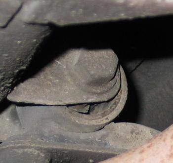

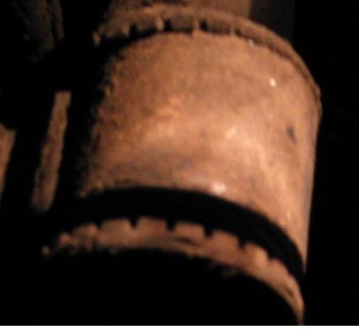

  7. I checked the muffler and exhaust system and could find nothing loose or rattling. I also jacked up the car and attempted to wiggle and lift the rear tires, but could find no play. I did notice what looked like some play (gaps) at the crossmember bushings when both rear wheels were raised off the ground. I have attached a couple of pictures. This may be the normal appearance of these bushing locations, but I don't know. What do you guys think? Thanks.

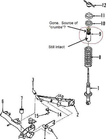

  14. I started on a project this afternoon to replace the rear strut cartridges on my '91 Loyale. I removed the passenger side strut and while handling it, material resembling bread crumbs started falling out of the upper portion of the assembly. It seems that the upper portion of the strut bumper (#9 on the attached diagram) is, well...gone. The lower portion (the plastic cylinder) is present, but the upper part I believe is the source of the "crumbs". It seems the bumper is made of some sort of foam rubber that got crusty and simply crumbled away. Now my questions: how important is this bumper? Can I get one some other place other than Subaru? 1st Subaru Parts wants $37.19 to replace this crumbly bit of rubbish, and I assume I'll need one for the driver's side, too (I didn't get that far). If someone knows of a generic replacement for this, I'd love to hear about it. Thanks!
