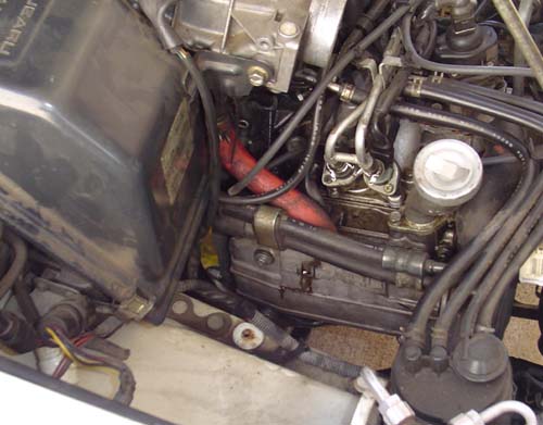

Identify this leak
drewcifer85710 replied to drewcifer85710's topic in Old Gen.: 80's GL/DL/XT/Loyales...
Thanks for the good info. I should've mentioned that this is the car in my sig, '86 GL-10 4x4 turbo wagon. The motor only has 60k or so on it. I'll have to check to see if the driver's side hose is simliar; may as well correct that too. As far as I can tell this is the only big leak, at least there aren't any spots on the driveway to indicate otherwise. It's an annoyance because it'll seep out overnight and then cook off the valve cover on my way to work in the morning. It's smoky and smelly for a minute or two. -
Today I finally got around to doing the airbox mod that caleb planted in my head a while back (thanks!) and while I had the airbox off the car I finally found the source of a really obnoxious oil leak. I don't know this engine too well though, so can someone help me out and identify that fat red hose with the oil seeping from it? Sorry I couldn't get a better angle on the pic, but the leak is at the end of that line, which is obstructed. Thanks Drew

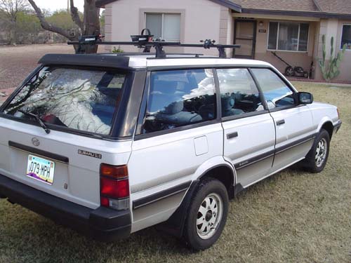

I'm asking this more out of curiosity than anything else. This is the car in the sig. It has a set of stripes down the side and gray decals below the moulding. I haven't seen this on other cars. Is this from the factory? Also, I'm missing the 4WD TURBO decal that goes on the rear hatch. Any ideas where I might be able to come up with one? Thanks, Drew
