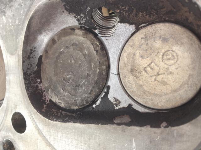

	Thanks for all the input on this... this is a pic on one of the cracks in the combustion area on the head... they are all like this.. in the middle like previously mentioned...... Just figured a picture is best for everybody to see... So resurfacing my self...... I want the head to be true removed of any warping..... How can this be done.... without a milling machine ? Where do you recomend I get a kit for lapping the valves.... or if you could just provide me with a link to such a kit.......... MilesFox.... wondering if you could explain the peening on the gaskets? What do you mean ? Thanks, Micky
	Geez. I got this smartphone but It hasn't made me smarter. There I was stAring at those cracked heads At the parts store. And I didn't get A picture. So will describe. Cracks are between Valves starting in the casted area the Cracks proceed towards the exhaust Valves down towards the valves and Give an unclear impression that they Go toward(through) the seat A picture says 1000 words. Sorry for the lack of a picture
	Yeah, He is going to send them back to me (from their machine shop to the part store) I will look at them and probably send them back to be resurfaced to look at........ I think he said, the crack goes in between from one to the other like I------E dotted line representing the crack between the I ntake and E xhaust....... What is a TSB? Also the valves were not removed... they are just doing a resurface....(this place;they don't remove the valves) so he didn't look inside the port... crack is between valves in combustion chamber part of head. thanks
	Hi, Yeah doing a timing belt... the car always leaked like a pig so I figured that I would regasket the motor..... you know new head gaskets etc....... so I dropped off the heads to be resurfaced... The old place I used to use went out of bussiness.. too bad........... So I used the parts place that I use..... Anyway, I get a call they are telling me the heads are both cracked...... now... mind you the car ran fine..... I had no complaints about how the car ran..... It just was the timing belt snapped....... Any thoughts on this cracked head story... I really don't want to buy new heads at 250.00 a pop........... Again, the car ran fine..... Thanks, Micky:horse:
