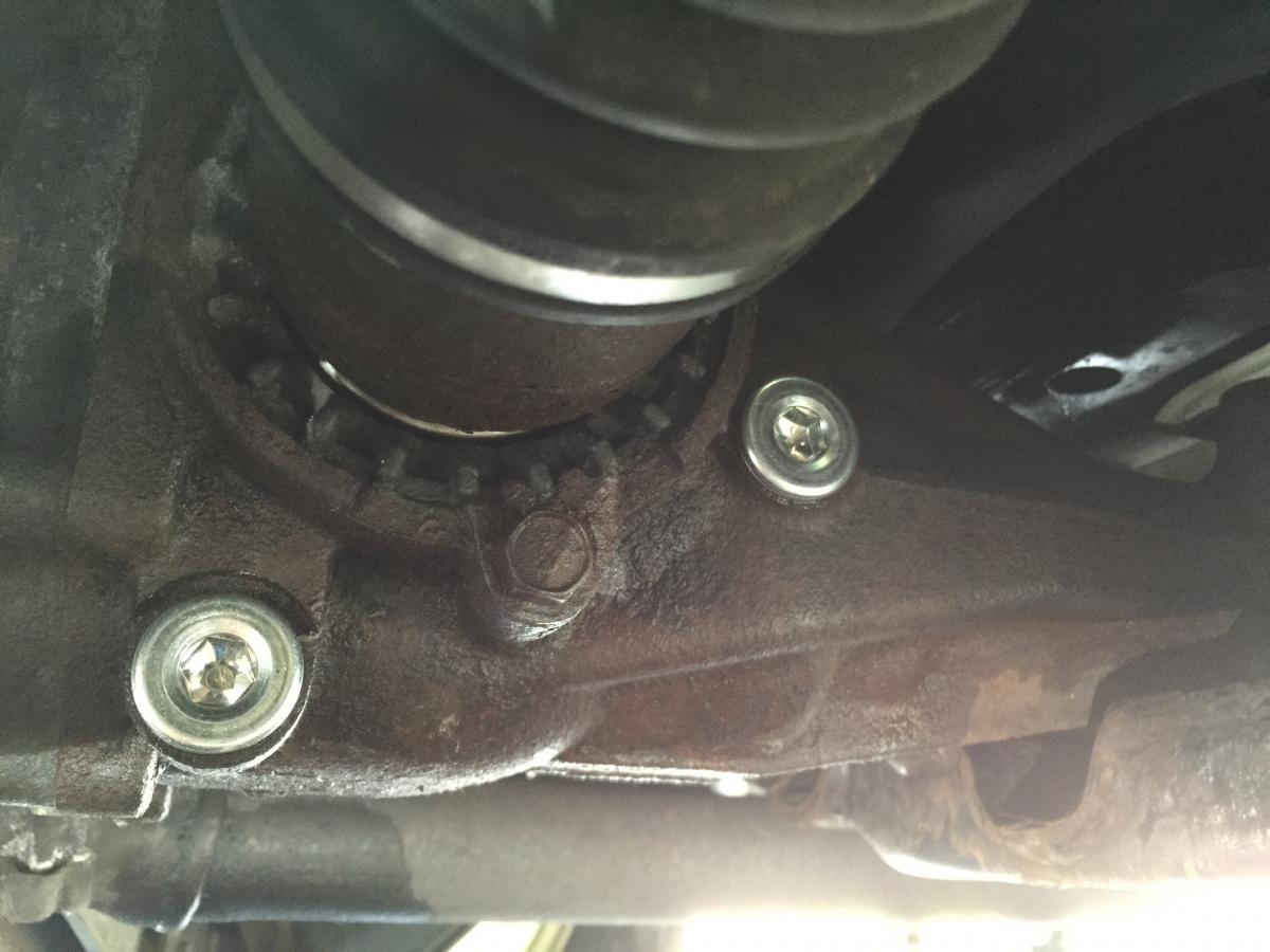

  8. All done the drain for some reason was a T-50 which is odd since they both should be Hex but I put new plugs in with washers so that takes care of that.
  9. I thought about a 11 mm hex but I just deiced to focus on the corroded rear diff wire yesterday as it was starting to become dusk. I will give it a shot
  10. Well I fixed the rear diff wire but I wanted to change the fluid today and I see the fill plug is stripped with the 10 mm hex so how will I be able to get the plug out? My only thing I could think of was wielding a 10mm hex on it and getting it off.. seems like someone tried to wack it long time ago. Now I assume the dealer has new fill and drain plugs? I can't check the part numbers on my phone but if someone has them could they list them? The drain plug seems to be a T-50 torx plug.
