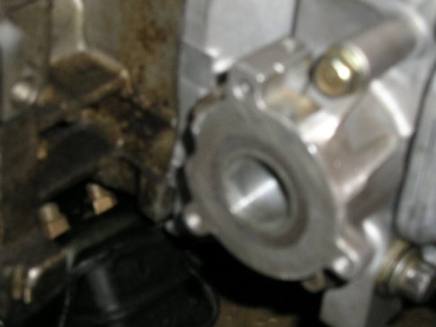

Yes--It's possible--take a look at my other post on a EJ-22 into a '82 GLF autocross car--I used the offset housing from the driver's side of the engine (got another one from a yard for $10) & lathed a bushing to accept a EA-81 dist modified at the drive end with a honda dist drive dog--You need to slightly cut down the dist body end & inner shaft--the honda 'dog pins with a redrilled hole in the shaft (the 'dog is a floater--allows for "slight" mis-alignment) & set the front for TDC #1--The passenger cam from a early ('90/'94) has a offset slot made for the type of 'dog honda uses---I've got a pic of the housing mod & the modified 2.2--expecting 180/200HP with Dual Carbs.

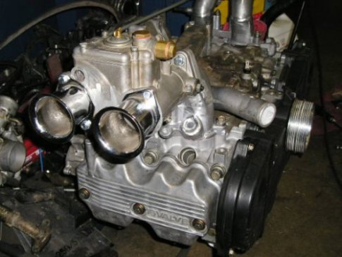

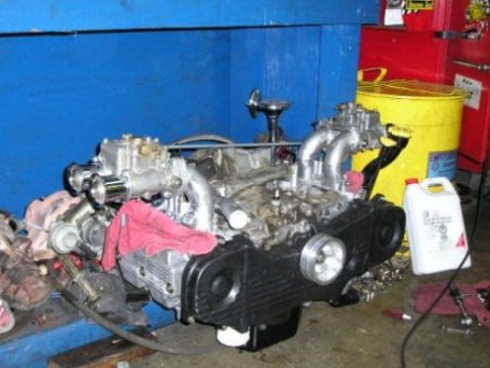

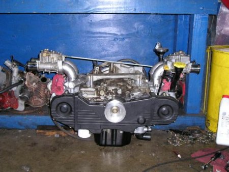

Well--I've not posted here in almost a year--the world & life in general as usual--happens. In any case--I know that several people have wanted to know how to mod a dist into a EJ-22---I'm here to say you can & here's how. Most of the earlier EJ-22 cams have a offset keyway cut into the passenger cam rear--This area is covered by a "blanking plug" that has two ears bolting it to the block. This "plug" IS EXACTLY THE SAME layout as the cam offset carrier on the front of the other head (see the first picture) I cut the excess off the extension & machined a bushing on the inside to match with a "normal" dist shaft diameter--I have modified a EA-81 dist to fit--you need to shorten the shaft & body length & use a Honda offset drivedog. I'm re-curving the dist to use centrifical advance only--you can use the vaccum if it is a street car--next you will need to find "true" TDC & mark the front crank pulley--align it with the marks on the T-cover.. O---And I'm including the other picts just so people can see a 200HP CARB'D EJ-22
