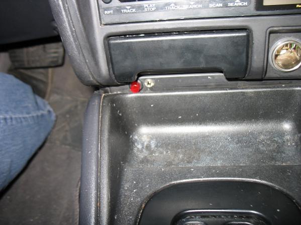

So I hacked in an audio jack to hook up my 1st gen ipod. Just slightly modified instructions found here. I got a 1/8 stereo jack from RadioShack (P/N 274-0246 for those interested) and a small push-button on/off switch. Picture is attached. A bit dusty around there 'cause I took the pic before I cleaned everything up. As for my question, I noticed that there is no power in the lighter outlet. All the wires seem to be intact. I am pretty sure that there used to be power there before, and I didn't do anything to it while wiring the stereo connections. Here's a pic of the wires, for what that's worth: Does that look about right? Is there a fuse I could check for?
