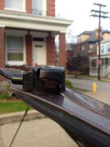

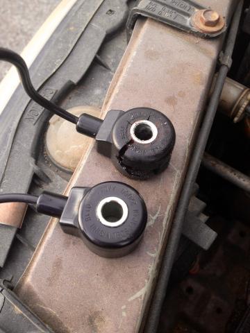

Ok, I value my sanity. I come to you, the fine people of USMB, hoping to finally figure out *TWO* quite perplexing issues. Here they are (on two different cars) 1st- My wife's car is a 1995 Legacy LS wagon, automatic, 2.2 liter. I've replaced the knock sensor (which was totally destroyed), and I just replaced the engine coolant temp sensor. Both caused the car to run increasingly better after the individual jobs were done, but the car is still experiencing sudden stalls when braking at stop lights or stop signs. Nothing dramatic happens now that I've changed the ECTS. Before I did, the car would rev up and down, freak out, then stall. Now it just drops and stalls. Absolutely no CELs, and the car seems to run just fine, all things considered. ANY idea what it could be??? 2nd- My car is a 1995 Legacy Outback, wagon of course, 5 speed, 2.2 liter. The heater/AC doesn't work. When I turn the switch, I hear a click in the relay, and when the AC is engaged, the compressor kicks on and everything seems fine, but nothing blows the air. Today I did a lot of testing, and here's what I found- Everything is getting the proper voltage, all the way to the blower wires. My blower is perfectly fine. I put it in my wife's car, worked just fine. I put her blower motor in my car (her heat works great), nothing. The most perplexing of this all, however, is this- When I put the windshield defrost on and turn the switch, the radiator fans kick on. This was all done while the car was on ACC, but it also kicked the fans into a higher speed while the engine was running. What. The. Hell. PLEASE HELP!

The CEL only kicked on recently. It has been running like total garbage lately. Agreed. I want to know where to get one cheap enough to do this...
