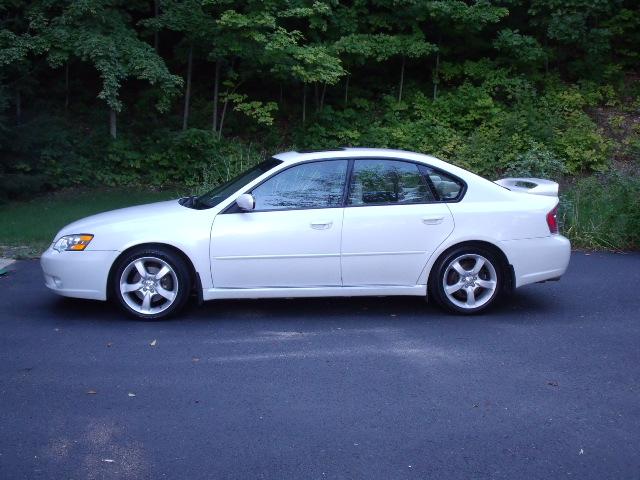

Now that this ridiculously long winter is winding down i have been washing my pearl white 2006 Legacy Ltd sedan at the local car washes. I purchased this car last Fall after spending 10 years in a 2000 Legacy wagon that was slowly rusting out before my eyes over the years. Imagine my shock when after recent car wash i noticed many tiny rust spots around my fenders and side panels. When i pointed them out to my 19yr old son he informed that they were caused by particles coming off of my metalic brakes. Id never heard of such a thing before and thought he was crazy but inside id hope that is was true, at least that could be remedied, a rusting Subie once it starts rusting could not.
