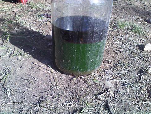

Does this look like a blown head gasket???
fiber_tek replied to fiber_tek's topic in 1990 to Present Legacy, Impreza, Outback, Forester, Baja, WRX&WrxSTI, SVXDisregard the part about the oil in the antifreeze.... My son wanted to know what it would look like if he added oil to the antifreeze and poured some in it... Ding dong kids!! Anywho, I need to start another post, we have another problem now.
My son just bought this car, 95 Legacy Outback 2.2L, and it had overheated. We are in the process of replacing the water pump and timing belt and saw this coolant settle out over the last couple of days. This isn't heavy like oil but it is darker than the rest of the coolant. Would a block testing fluid still be able to test this after it is out of the vehicle? Thanks for the help! I've had a lot of good help on this forum!
