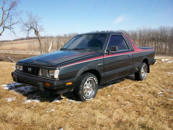

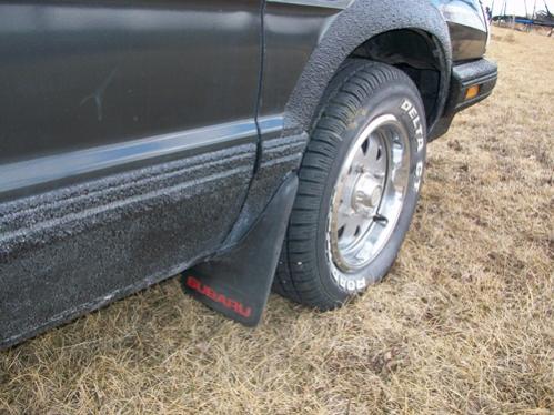

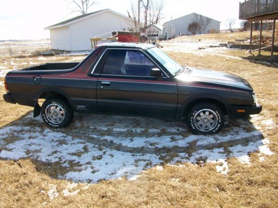

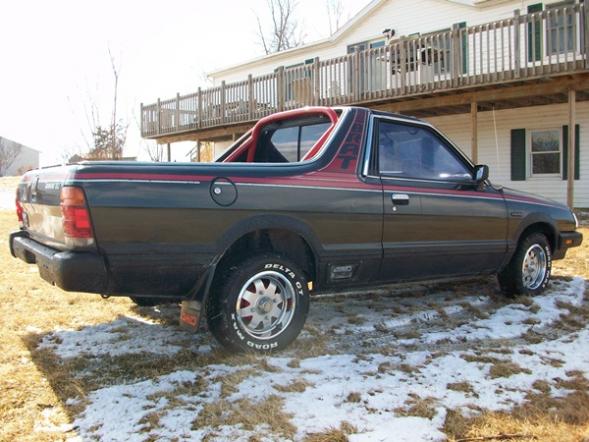

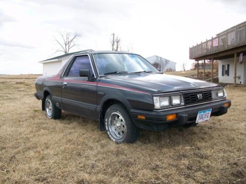

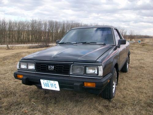

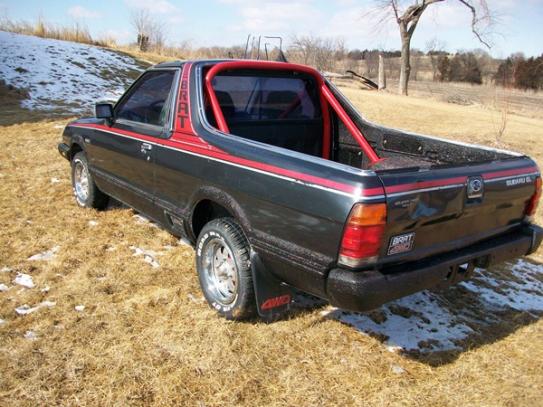

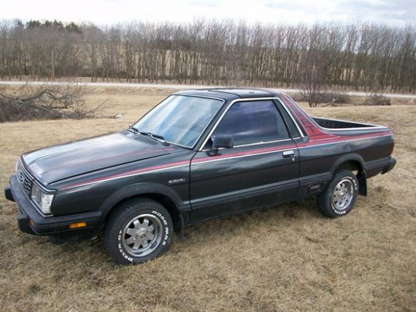

  11. Here is my BRAT. I have asked questions from you all for a while. Thanks for your help. She is a 1985. I got it for 800.00. The motor had a broken crank. I put the 83 engine in it, bedlined the bed and lower areas, new seats, new clutch kit, exhaust, front and back mudflaps, silver painted rims with new Delta white letters and more. I got about 2200.00 in it now. It is pretty nice for its age. There are some dents but not bad. The tailgate is the worst. Mostly craigslist and ebay built. I have posted the photos before in another post but thought I would do it again because I got a lot of interest and questions. I still have to switch over the A/C, tighten the shifter and get the bugs out but it is ready for daily driving. I like it so much that I hated to drive it in the dirty gravel. I just took her for her maiden journey with new cv shafts and the problem is that there is a clicking when under load. It seems less when in 4 wheel but still does it. It does not when not pulling. I had originally put one CV shaft on only as it came with the rig in a box but then when it was making the sound I assumed it was the driver's CV. It helped by 75 percent but still has an issue. It is definitely related to the rotation of the axle shafts and maybe on the left side. It has new brakes but I did not pack or check the bearings but it did not seem like a bearing sound. I felt the bearings as I did it but should have kept going and pulled them I know. I fear it is the tranny. The thing has 108,000 original miles. The oil is clean and refilled in the tranny. It was about a pint low (3/8 inch up dipstick) so I added more. I added half a quart and it still seemed low so I added the rest and now it is about 3/8 inch too full. I have not driven it since I added it. Could it have been low and causing some noise? Is it too full for safety now? I figure I will suck out some oil to be safe. Come on guys, you have been here all along, don't let me down now. Oh, yes I did tape the mudflaps and paint them to match the roll bar in the back which is close to the stripe. I also sprayed clearcoat on the paint to freshen the peeling clearcoat and to help and protect it. Don't let anybody tell you it cannot be done because it looks pretty good. I did not have anything to lose. The tires set me back 432.00 bucks. I tried ordering others but they never were in stock. I finally gave up and went to a local guy. It was the only ones he could get. (he thought I was crazy) They look great though. It came with new mud and snows on it but they were 165/13 and looked like crap.
  12. Here is my 85 BRAT. I have been asking questions for help for a while. Thanks everyone. I still have some issues but the list is getting smaller. I finally got to drive it today. Some of my mods are. Xtreme Liner in the box and around the skirt. New trim rings, new and expensive 205-60-13 white letter tires, seats from an Audi, 83 EA81, factory mud flaps, sweet roll bar. I still have the chrome tailgate trim coming and factory front mud flaps courtesy CL. I bought her for 800 with a broke crank. She was abused. Got the motor for 125.00 and the rest from ebay and CL. Roll bar was in her but poorly mounted. No seats but I really do not want them. The paint was bad but I took a chance and repainted the hood with a rattle can over the top of the peeled clearcoat and clear coated all the roof and from the strip up. I thought it would look bad but it looked good. I sold my Polaris Ranger and convinced my wife the BRAT would be it's replacement at 1/4 the price plus have heat, air and more. It has a slight miss in one cylinder. I can hear it at the tail pipe. I put in new plugs, cap and rotor. I am considering swapping the original intake and carb from the 85. I also have not adjusted the valve lash. (I forgot when the engine was out so now I have to do it the hard way). The engine does have a decent amount of tappet sound so I assume the valve lash needs it. The other thing was that there is a ticking that is loud on the drivers side when you accelerate. When you let off, it goes quiet. The passenger side has a new CV shaft. I may just throw one on the drivers side. Any ideas what it could be?
  13. Does anyone have a pair of front "subaru" mudflaps available. I got good rears, just need fronts or at least a left one. My BRAT is almost done, will post pics when I am. Thanks:headbang: Sorry, Gen 2
