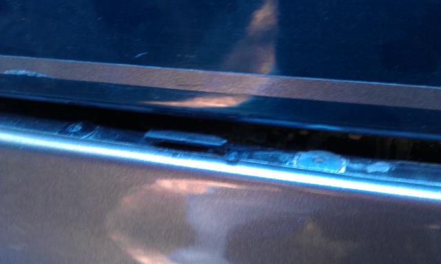

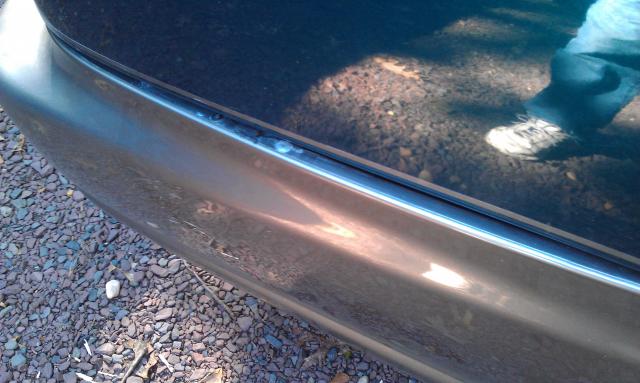

  13. The rear plastic bumper cover is buldging on each side of the quarters on my 99 obw. It looks like there is a clip inside but i just cant figure this out!! Car looks great except for this, anyone removed or fixed this before? The manual just says "remove clips". Yeah, thanks. Thats helpful. Like saying "Remove engine". Not even a decent pic.
